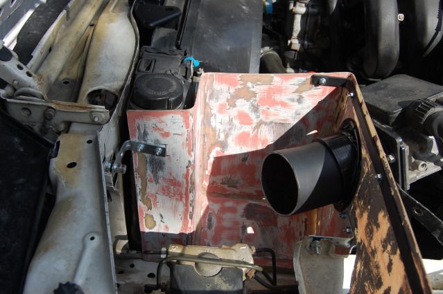

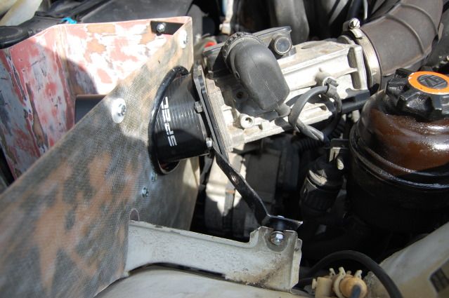

« Reply #19 on: March 25, 2012, 10:43:53 PM »

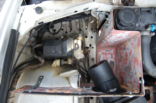

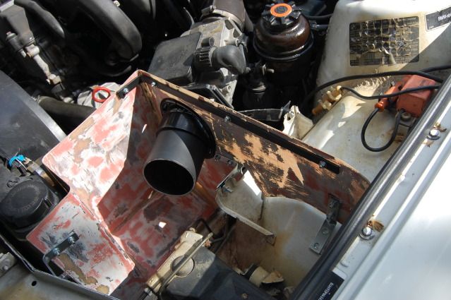

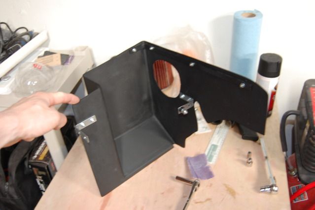

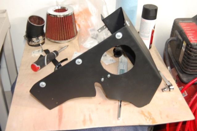

So I finished the final fitting of the airbox and snapped some pictures. I had to get rather inventive with mounting the box. I used only existing mounting points and holes that were already in the engine bay.

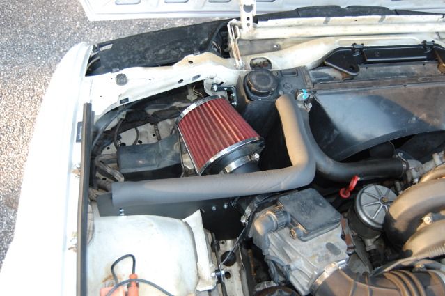

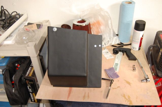

And lastly here it is painted and with all the hardware mounted and ready to be put in tomorrow morning.

Homemade Heat Shield For Intake
« Reply #20 on: March 26, 2012, 05:38:35 AM »
Nice piece of fabricating work there. Looks good!

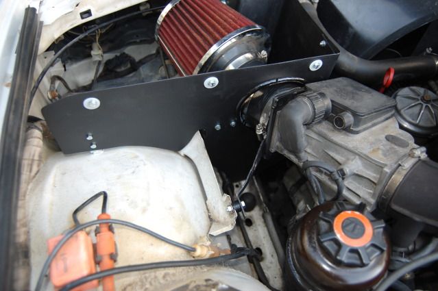

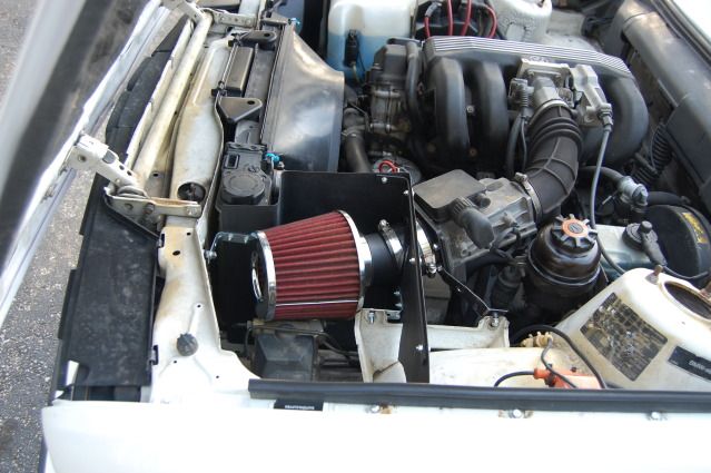

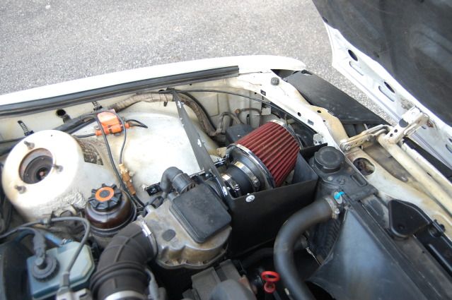

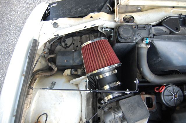

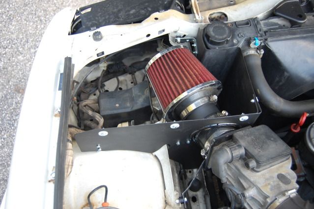

Ok so I got the whole thing mounted up but have put on the top insulating tube yet. This generic filter will be replaced with new smaller cyilndrical filter later. Here are the pics.

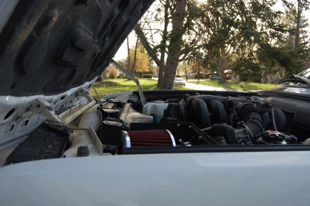

Here is the clearance from the hood which will only be better once I get the new filter.

« Reply #22 on: March 26, 2012, 03:26:59 PM »
Looking good.

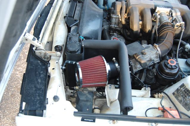

Nice. Any plans for a seal/finishing trim on the top edge?

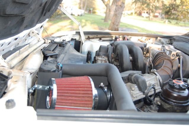

« Reply #24 on: March 26, 2012, 06:35:55 PM »
Quote from: MLM;111428

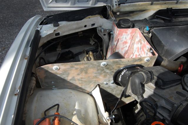

Yes sir I put that on this evening and have some pictures. Here is the final product and the way it will sit.
If there are any suggestions or comments on something that may make this better let me know.
« Reply #25 on: March 27, 2012, 01:33:27 AM »
Nope looks good to me. I used very similar stuff but smaller diameter as you would have seen. It must work as the inlet temp sits steady at, on average 3 degrees above ambient while stationary.
Good job!
