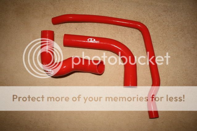

Silicone hose kit, e30 M42
« Reply #28 on: July 29, 2011, 09:57:55 AM »
We do an SFS performance 3 piece coolant hose kit here in the UK.
Looking into doing the induction boot too.
http://www.visionracingdevelopments.co.uk
« Reply #29 on: July 29, 2011, 08:54:29 PM »
Matches my red hoses...nice.  Do you ship cross the pond?
