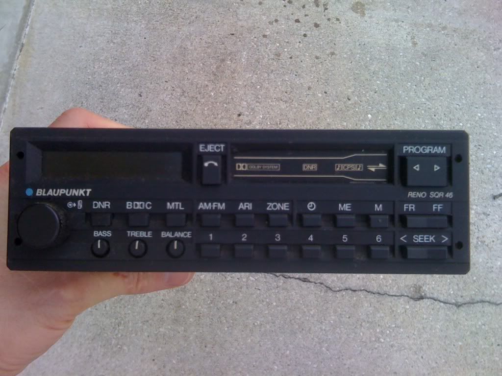

I'm trying to wire a Blaupunkt Reno radio in my car. I'm not sure what the cars come with originally, but the connections might be a little different.
Does anyone have pictures of the wiring and the back of the radio?
Any wiring diagrams?
Does the radio in the car have an amplifier?
PS. Still looking for the four speaker conections on the back of the radio.
My back of my Reno radio:
http://i1143.photobucket.com/albums/n632/a930rocket/DSC02243222.jpg

Mate I have been around car radios for years and never seen anything like that how old is it?

It's out of my 1987 911 Turbo. 24 years young!

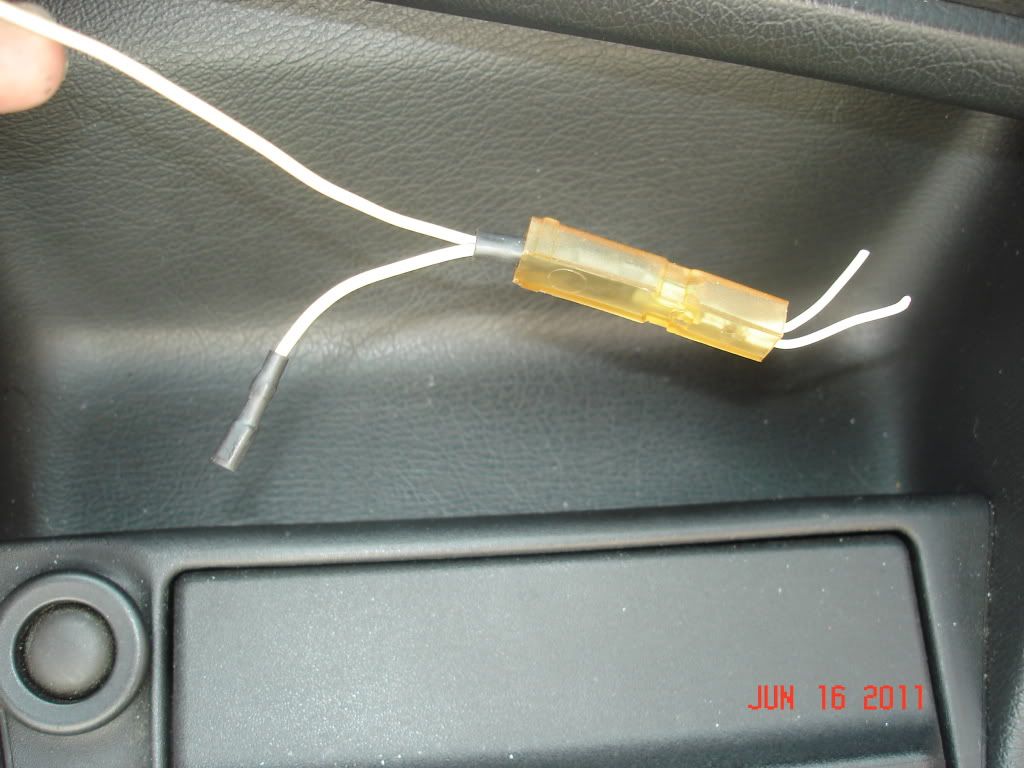

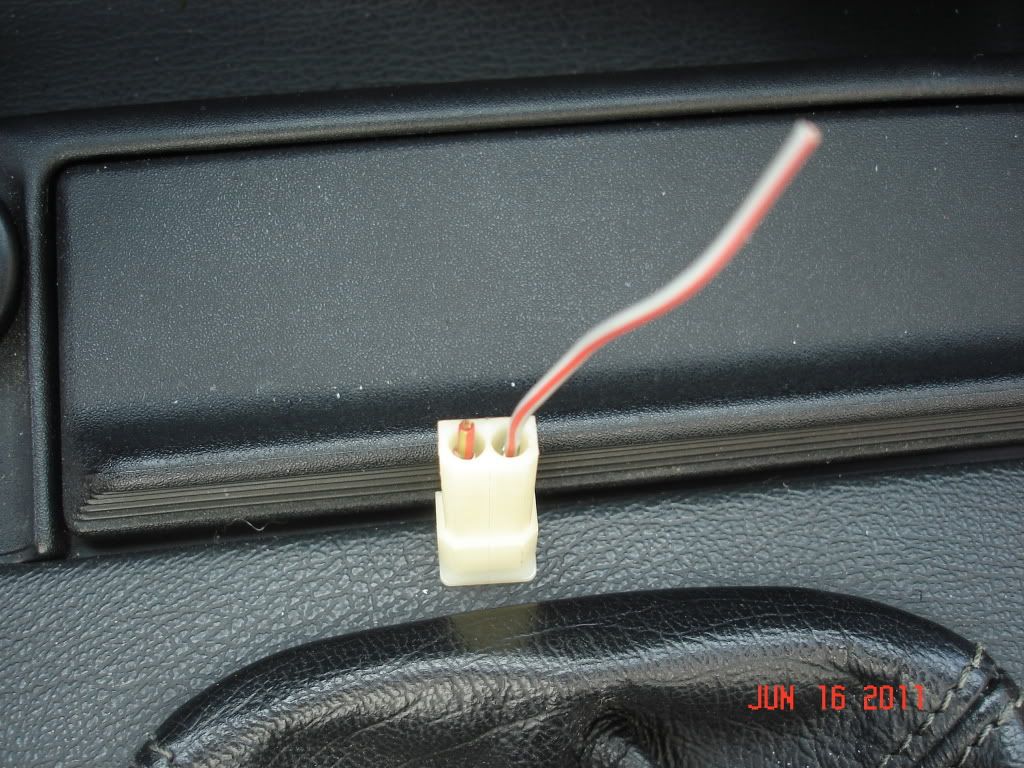

What I have left is another thin white wire, a grey/red wire ( radio face illumination, but where does is plug in? ) and the four speaker wires.

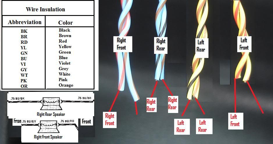

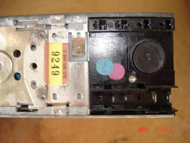

All of my speaker wire pairs have a blue or yellow wire with a brown tracer. Does that go to the round or square pin on the connectors?

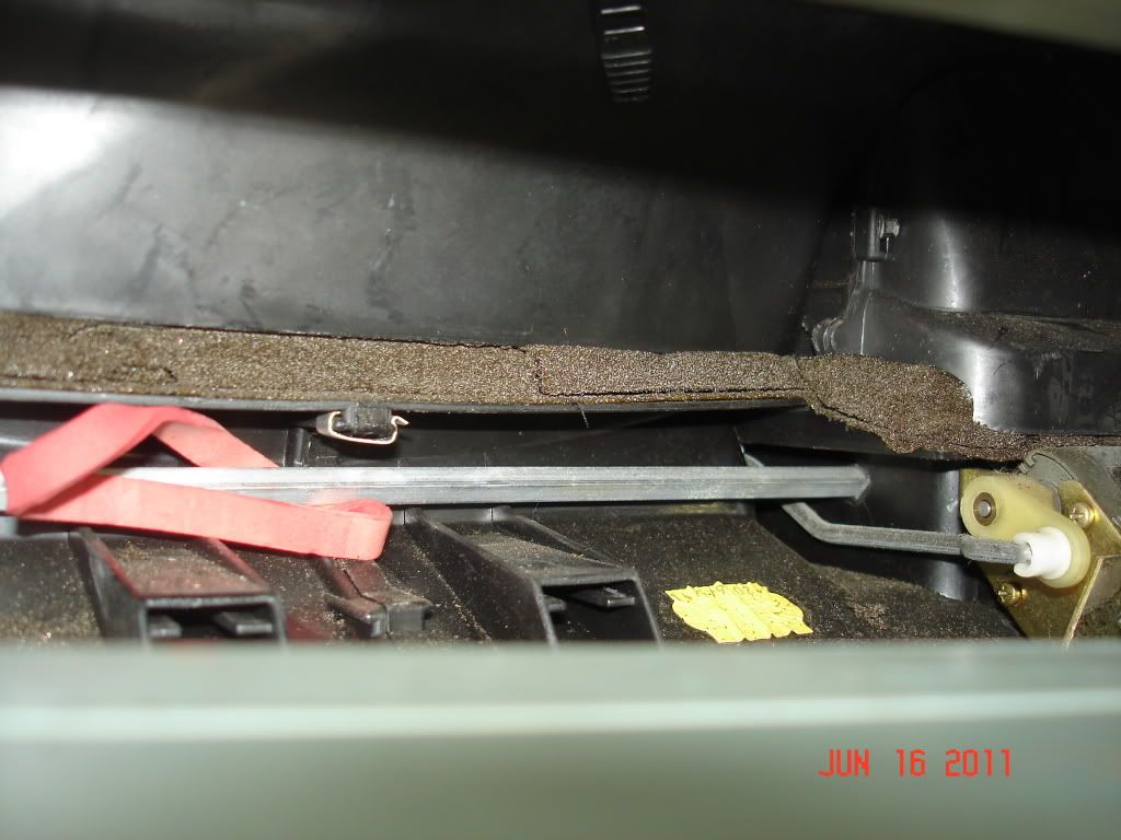

Another question. When looking inside the radio slot, there is a red rubber band looped on a square rod that goes side to side. It's slack and seems to do nothing. What is that for?
Red rubber band:

This thread has the OEM Alpine unit I had.  From what I can tell for each speaker pair the positive runs through the round/skinny pin; ground is the flat/wide one.
