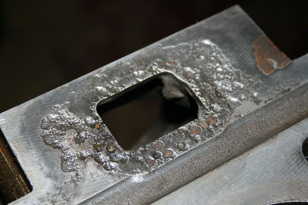

Never used the M42 in my cars and therefore haven't been able to figure out what might have happened here - anyone have any ideas?  Almost looks like it overheated, blew a head gasket, and the fluid leaking at this section of the head ate away at the aluminum a bit.  Any ideas?  I'll have to see if its something that can be fixed with a little welding and shaving.

If that's the bottom of the head (with the infamous profile gasket), I'm told coolant does that with cavitation.  But the two parts fit together tightly, so I've never really understood why.

Interesting - found additional info on this potentially being the result of electrolysis.  Guess now I need to see if I can get this fixed or if I need to buy a new head casting.

If you've got a good welder friend, you could grind it out, weld in and re-machine ti to the same height.....
I would just leave it alone.  the material thickness is adequate for another few hundred thousand miles and unless you need an as new finish it will survive.
Make sure you use the right coolant and all that kind of stuff that we all know.
