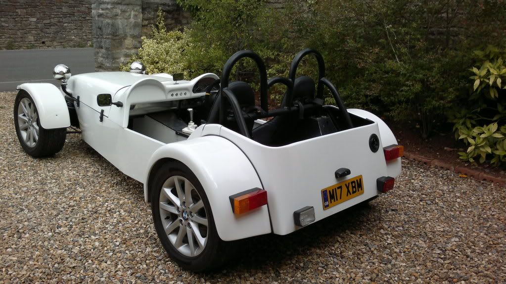

Hi,  been reading and around for awhile and thought it was about time I put up a pic of a project coming to the end of the first phase.
Stripped an E36 318is and rebuilt into a Kit Car GKD Legend.
Small case LSD 3.38, COP conversion from the later coil pack, short shift, induction and a somewhat non-standard M42 exhaust.
Thanks to all those who post so knowledgedly on this site, very generous and helpful to those of us with less ability and knowledge.
End result is now all ready for getting the registration process done, passed the various other legal requirements now. So, should be out on the road with Sunshine soon :)

A few details:
Starting car was a Jan 1995 318is:
  • Total weight is now ~650Kg with full 42ltr tank, so more than a bit lighter than the E36.
  • BMW 318is disc brakes all round, steel braided brake hoses, not really felt the need to upgrade the calipers or pads yet.
  • Suspension is fully independent GAZ adjustable all round.
  • LSD at 3.38 on E36 mounting plate and Getrag 250 with Z3M short shift.
  • M42 with COP conversion from the later coil pack(makes it a bit more awkward)
  • Induction Kit.
  • Stainless 4 to 1 exhaust pre cat

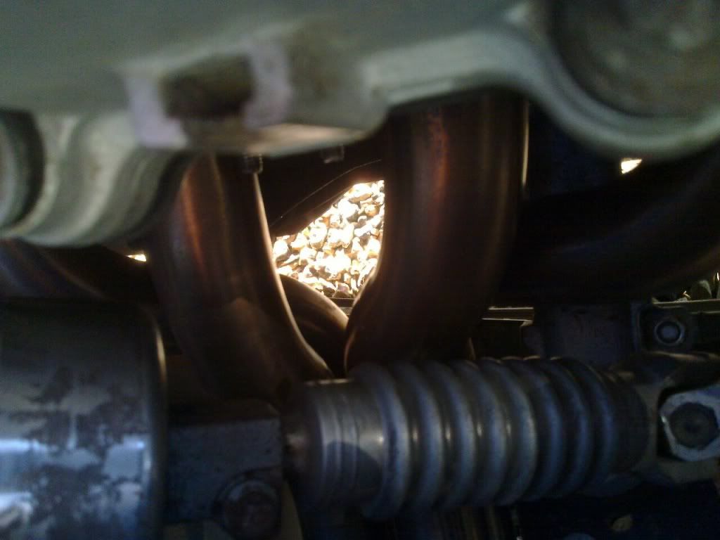

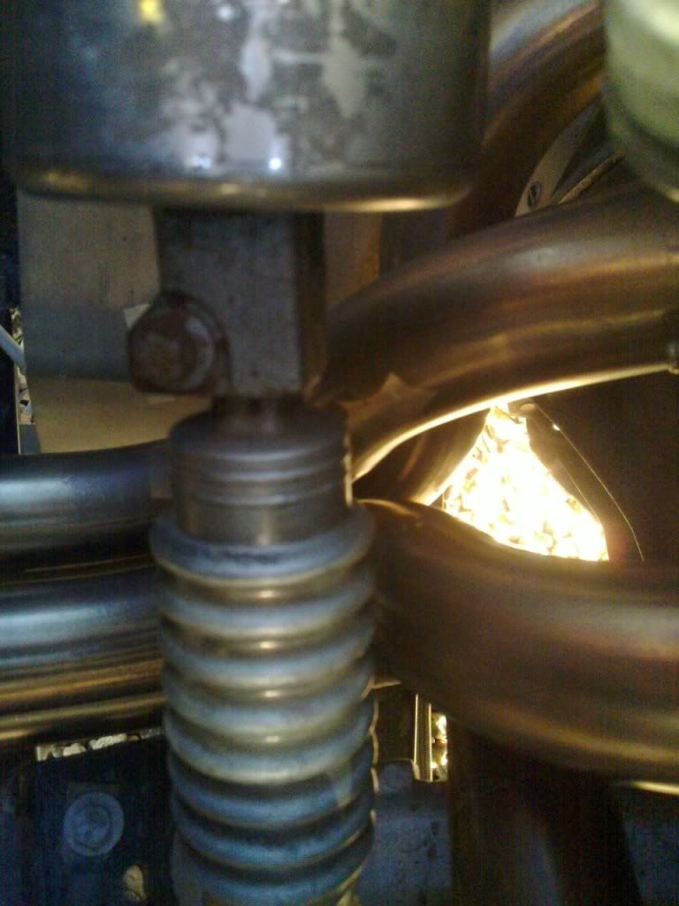

A couple of pics trying to show the exhaust mainfold route around the steering column. You really get that M42 crackle at higher revs from this :)

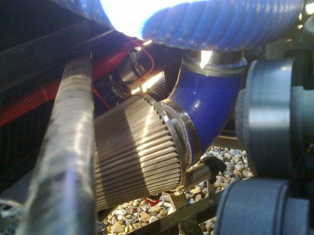

Intake - used one intended for an M3,  work to be done here to box in with a colder air feed, makes a good sound but gets a bit lost with the exhuast as a driver.
