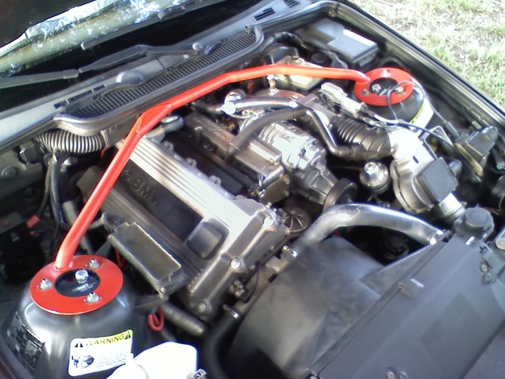

PS: Here are a few older shots...beofre I did a few other things (like relocate the RRFPR for instance). Sorry they are terrible cell phone pics. I desperately need to clean the engine bay up when I get a chance.
« Last Edit: December 05, 2010, 07:46:56 PM by Hodge »

Oh I found a more recent pic...relocated RRFPR, TMS camber plates, etc.
1995 E36 318isc
