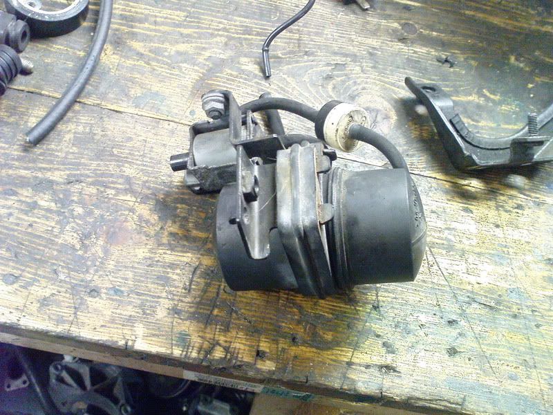

hi everyone
does someone know or have a photo where i have to the vacuum reservoir
i like to know this because i have a m42 out of a e36 but i did not get this part with it and now that i have it.
i do not know where to put it exactly.
i hope some one can help me with this
grt hilbert harm

this is part of the DISA system in the E36 M42 engine.
it controls a flap door that selects air flow between the long and short runners of the intake manifold.
if you have an E36 management and wiring harness - than all the required parts are there and you should only connect that.
it goes underneath the intake manifold, and two screws are holding it to the manifold support bracket.
hope that helps
