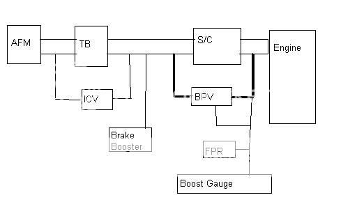

sorry, could you post some pics so we can see if there is something wrong in piping or setup?
you already calculated pulley ratio?

i'll post a pipîng diagram later today

Here is how she's all plumbed up!
