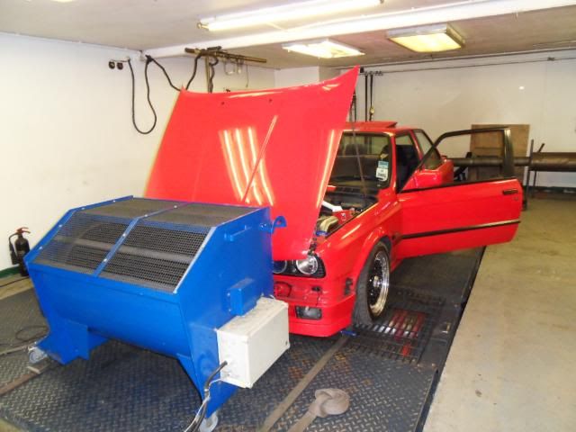

« Reply #5 on: August 05, 2010, 11:15:25 PM »

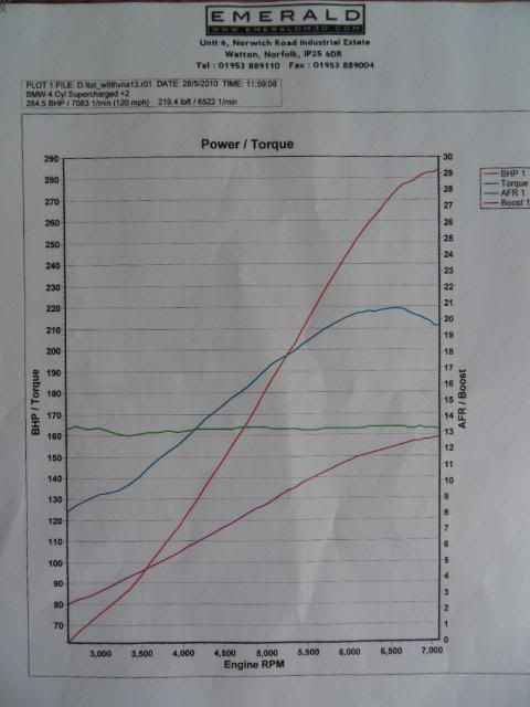

It's running 12.5psi boost and got 285bhp and 220 ft/lbs @ 7000rpm
On the rollers
« Last Edit: August 06, 2010, 01:06:43 AM by Appletree IS supercharged »

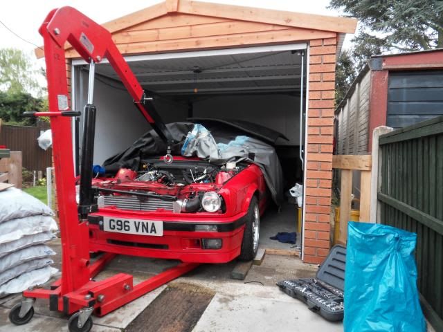

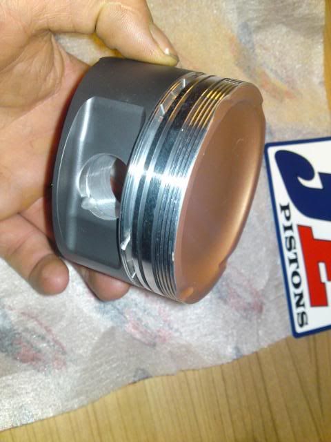

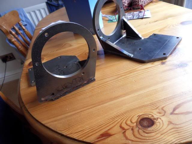

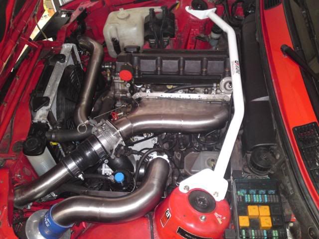

Few more random pics for you from through out the build

Hey Appletree, Awesome!!!  Is the AFR optimum power for that motor or did you run out of inj?
~Ralph
  • Posts: 66
285BHP rotrex supercharged M42
« Reply #9 on: August 06, 2010, 08:49:25 AM »
Hi, the investors were running just under 80% at the last run. The guy who mapped the car also builds the ECUs and is a bit of a legend when it comes to mapping cars, Dave Walker is his name.

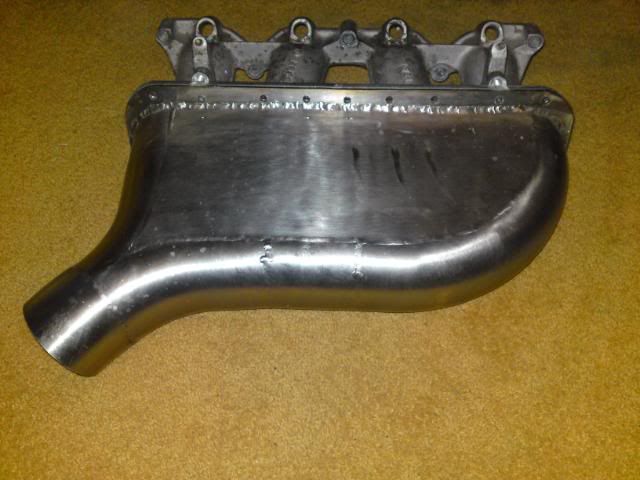

Made my morning! Did you build the intake yourself?

God I want your manifold :P

Yup built every thing myself,
Boost pipes, manifold, brackets a pullys were all made by myselp at home in the garage

Yeah just wondering if our cars happen to like a little bit leaner like 13-13.3 where yours looks like it is versus the usual 12.8-13
