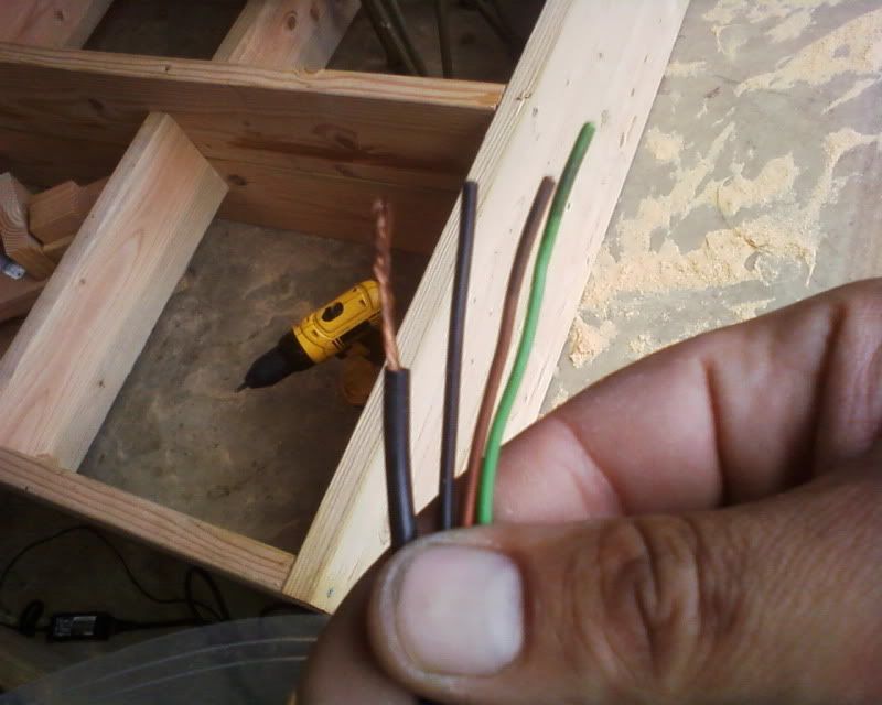

rg6 is cable television coax. I'll see what I can find on "kabelmetal".
anything here look like it?
« Last Edit: July 03, 2010, 07:34:19 AM by jscribble »

I can't dig anything up.  That's really odd.  There is a KabelMetal of Hanover that specializes in wiring of this type but I found nothing else relevant.
I'll bet that this wire is shielded to prevent overloading the coil transistors in the DME.  These coil packs have been troublesome for BMW.  I'd bet you could splice a bit of normal auto wire in there and it'll run like it should.  The amount of RF interference on coil wires is really high, I'd figure BMW put this wire there to eliminate DME resets.  It fits in with my theory that BMW over-did many things on the M42 (forged crank, sodium-filled exhaust valves, coil packs, etc) that can safely be eliminated.
If you wanted to restore the factory wire I'd just cut a length from a less fortunate M42 in a scrap yard.
I did find this great site again...
http://www.bba-reman.com/content.aspx?content=bmw_wiring_harness_faults_and_problems
They have some really in-depth technical explanations of BMW service recalls.  Scroll down until to the lower section of the page and browse the links in the BMW section.  I find that I worry a lot if I read too much of it...

Quote from: jscribble;94228
This is the closest, but there is no outer strand.
http://www.alibaba.com/product-gs/235928320/Flat_Flexible_Power_Cable.html
I'll try and get pictures of the dissected specimen up for you guys to have a gander at.

Never mind, I think I found a solution...I'm trying to delete an alarm from my '89 325i...and guess what?
There are three or four of those wires running through the main harness into the DME plug!  I think they're the same, I'll take some pics when I'm a little further along.

Here is the picture of the wires dissected.
The wire on the left goes over the smaller black wire that is second from the left.
