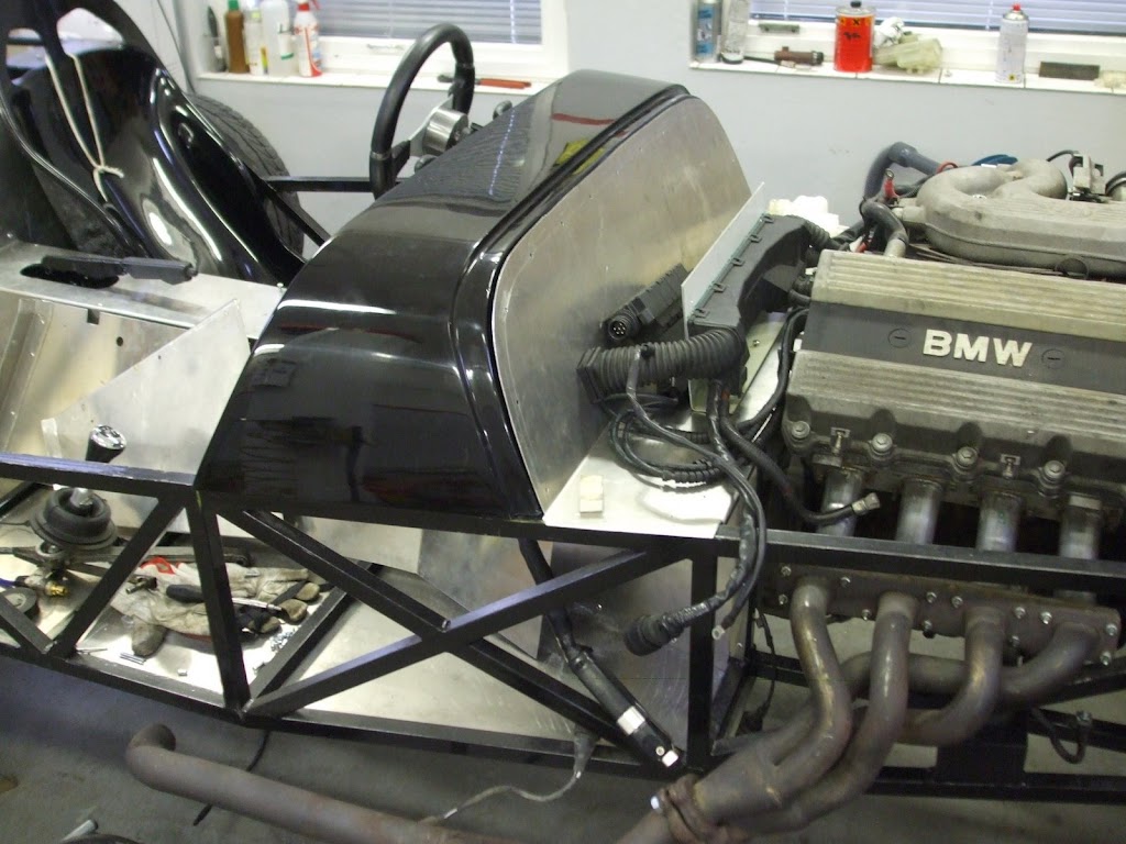

Quote from: Romrog318is;92809
welllll if you want to remain NA just do what i did ;)
He can't do that :p
He own this, less weight is everything in those cars :D:
COmpliments for the build! First seven I see with M42!
250hp on a m42, start removing mods from this list. Cams need to be changed.
http://www.stalheimmotorsport.se/index.php?pid=0&id=137
Have you considered going low boost turbo? If engine is in good status 200hp at 7psi are EASY to get!
- you have a lot of space in that car
- you have "hand working"-welding skills
- I see you already done a plate like collector here http://lh4.ggpht.com/_p9Z5-5F8Qmg/SVI6awqCgOI/AAAAAAAABwc/HLkKVgwWnPg/s1024/DSCF1078.JPG
   that's half of a turbo manifold already done :D
I would turbo it :D low pressure, small turbo to achieve a great driveability in that light car. think about it.

Quote from: nuvolarossa;92815
He can't do that :p
Thanks very much for compliments, my father has built it, it took him more than a year to do it during the nights after work and weekends :).
Thanks for the link but it's quite hard to translate it :).
We are using it for racing on slaloms events and we want to stay in category under 2.000ccm so no turbo :).
We want to run it on dyno next month so lets see. But we want improvements anyway :)
