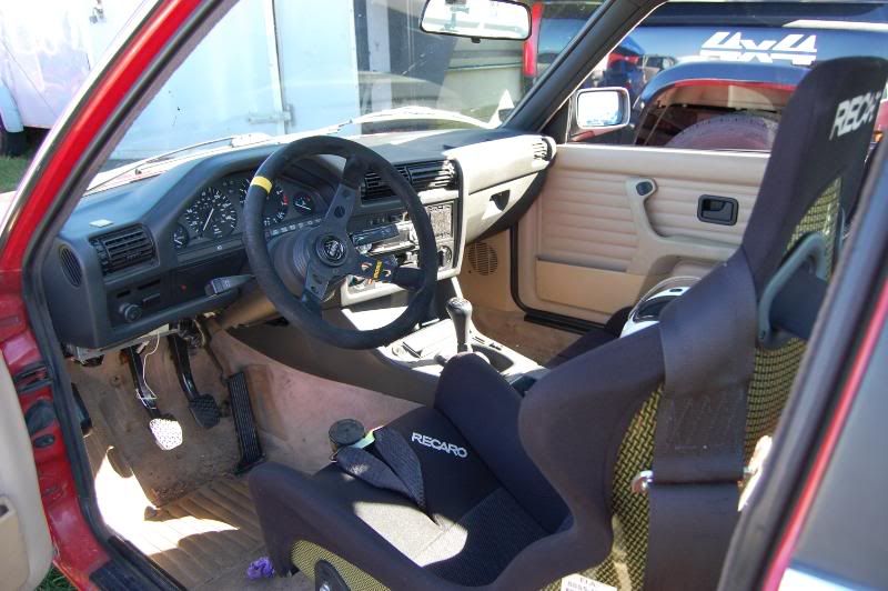

Been in the E30 scene for a year or 2 now. Bought my 89 325i as a daily driver to make into a track car and eventually racecar, but as I got to making it more of a racecar I started enjoying it less on the street and missing my old daily driver. So I started doing some research on the racing that I planned to do, and eventually came to the conclusion that an E36 318is would make a much better racecar for me while allowing me to put some creature comforts back in the E30 and take it back to full time daily driver. In the mean time, I'm currently doing NASA Time Trials in the E30 while building the E36.
Obligatory pics of the E30:
