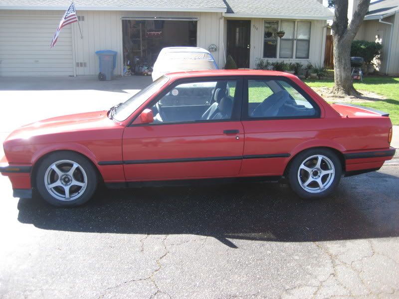

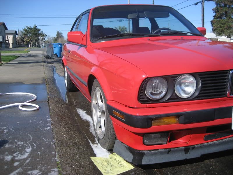

I've got stock M3 springs, bilstein sports and 15" wheels on my cabbie. Love it as a daily driver. Aggressive, but not too harsh. Good height. About perfect for my needs.
Photos here: http://www.m42club.com/forums/showthread.php?t=6053&highlight=tony92ic
I also removed the spring pads so its a little lower than if you left them in.
Tony

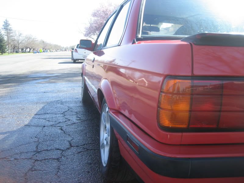

Car looks great! I just got all the parts I needed yesterday (E30 M3 springs/Billy HDs). Defintley going to get some new upper strut mounts and rear shock mounts to complete this. The e36 rack goes in next week as well.
You removed the rear spring pads and it looks way lower in the back. I'm wondering if there is a way to lower the front a bit more. Drop hats???

I get no noise from removing the spring pads.  I did put a thin sheet of plastic in as a replacement. I actually used a chunk of a Softner Salt bag.
The rear does look lower in the photos, but I've never noticed that in person.  Maybe because my driveway slopes toward the street, it caused that illusion in the photos.
You could leave the bottom spacer in the rear. It would make it easier. When i pulled mine, I cut up the bottom rear spacers so I could put the bump stop back in as it also centers the spring in the perch.
