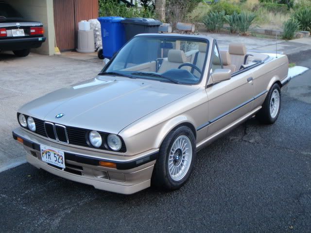

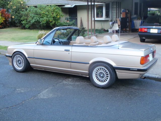

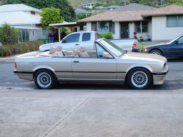

Been busy the last few days. Finally got the project E30 finished and sold(last pic).  In addition I finished the suspension set up on the Vert, which included TunerShop springs, Bilstein Sports, M3 offsets and the 15X7 Alpina reps. I’m really pleased with the setup and it’s like driving a different car. Hope you enjoy the pics.

I love the stance of the vert; good job!

Such a great looking car. Well thought-out.
