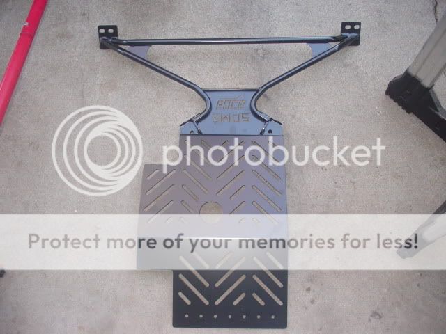

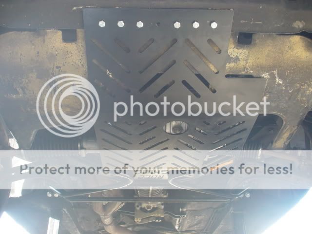

Vert Brothers, No rain Sunday, so I got out and installed this on my daily driver 91 318ic.
Sorry about the lousy picture underneath.
Race Skids cross brace and skid pad. Took about 90 minutes to install. Easy install. Bolts right in, plus had to drill 7 holes. Only used 6 of the holes, so I could fit the stock splash guard back in place.
Very noticible positive difference in handling and feel. Solid, way less body roll. Well worth the upgrade on the Vert. My next brace will be topside for the shock towers.
Gotta go find some twisties now...   :cool:

i still don't understand the design of those parts. an X-brace should actually be an "X", not two bent bars with some plate welded in the middle, and a skid-plate should bolt to something more sturdy than the rad support.
my mason X-brace and sparco-copy front strut bar stiffened the front of the car up nicely. i hope you're happy with your setup too.

I am, stiffened up very noticibly.  So, while it's not an x, it seems to work as intended.
While the skid plate protects the pan nicely, it is a pain to pull it off if you need to get to the belts from underneath.  I will say the pan is now protected...
Now looking for a solid tower brace for the shock towers...  Too bad there's not one available for the vert's rear towers.   :cool:
Quote
i've been watching the argument on r3v about which plate is best and this came out (from a guy who bought the race-skids piece):
Quote
I'll just repost my PM response:
I launch off that plate probably 4-5 times a week living in Chicago and its held up wondrously.
However, this time was from train tracks and really shitty pavement. The tracks launched the front end up, and all the weight of the car came right down on this pavement mound via the skidplate.
I think the plate has been beaten to the point where it was pretty much up against the oil pan, so the impact just transferred right to the pan.
It got me thinking though - what if you added some bushings to the top side of the skid plate, between the plate and oil pan? Basically small rubber cylinder bushings, only attached to the skid plate, right underneath the closest contact points of the oil pan. That way if you do really whack something with the pan, the impact between the skid plate and oil pan interaction is absorbed through the bushings. you might need a new skid plate, but at least you wouldn't need a new skid plate and oil pan.
No pics yet. Assessing the damage this weekend.
this is what i was talking about. a skid plate is supposed to be a reinforcement; and the rad support is not very strong. i've seen one out of the car waiting to go in and fix a front-end tap... the whole thing is less than 10lbs, you can hold it out at arm's length on a fingertip. and the other thing is that it's bolted up at either end, so the middle can flex; look at the reinforcement bar on the piece i posted; it's right next to the oil pan.
i've been in robert (peerless') car on parts runs while we were working on my vert, and he bounces off that thing like he's trying to win a prize at the county fair.
i'm not saying the race-skids piece isn't better than a bare pan... but exercise care nonetheless.
