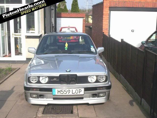

Bought the car about 2 years ago (think it was July/August 2007)
Spec was:
Standard sterling silver 318iS with 130K exactly on the clock with a few exterior factory options like the pin-strips and some added on bits like the shadowline grille and body coloured eyebrows and a 'Ring sticker after its trip there a year previously:p :rolleyes:
Other stuff was 17" Algernon alloys (popular in the VAG scene apparently)
Chip and re-map to a little over 150bhp
Lowered 40-50mm
Painted brake calipers
Timing chain just replaced but without sprockets etc so had to do it again once I got it home.
Was pretty pleased with it on my first trip, managed to keep up with a E46 320Ci all the way back from Wolverhampton and be more than capable of keeping up in the Welch twisties and still managing 40mpg over the 400 miles!
Although the fact that the Avons were pretty worn on the back made it feel like it had an LSD and the rear subframe bushes were giving it quite abit of "active YAW" in the long corners:D
Once I got it home, I did the timing chain and added a few things like the short-shifter, cruise control and 13 button OBC.
About a month or so later,
Next addition was a US spec E30 M3 LSD (that I got off a friend in a part exchange for the interior out of my 318iS trackcar) and some powerflex polybushes for the rear end (which I regret putting in as they are too fooking hard)
Also fitted E30 M3 eccentric control arm bushes
Next was an E36 rack conversion as needed to replace the subframe due to and engine mount pulling through it (resaonably common problem) so I had to get rid of the shitty E30 steering at the first oportunity I could get!
Did a few things like install HIDs, smoked headlights as the E30 lights are shocking.
Next up was replacing the shocks as the lowering springs had taken their toll on the standard shocks...
So got a set of Biltstein B8s and Eibach springs and fitted new E46 M3 rear top-mounts.
Next I upgraded to an E46 steering rack as I got one handy and needed to replace the steering pump so said I might as well put it in while I was under there!:p
Sold on my E36 rack conversion to a mate then to recoup some of the costs.
A new set of wheels was in order then as I was sick of 17"s on an E30.
Got a nice set of 16" BBS LM reps then with Toyo T1-rs
Few other little bits got added along the way then that are all in the spec list.
Latest changes are an E36 M3 Evo 6 speed gearbox which makes it great fun to drive and alittle quicker.
Only thing is the gearbox was out of a M3 Evo drift car so 3rd gear synchro is gone and a rattle lay-shaft (can't complain when got for free though so was handy as a test fit before I went out and bought an expensive gearbox that turns out to not work well or even fit!)
Then found a E46 M3 engine and box with roughly 30,000 miles so now putting that gearbox in once I sort out a flywheel to take the S54 clutch or a 228mm clutch disc that has the right spline for the gearbox to fit on my 325i lightweight flywheel that is currently in the car.
Last addition to the car is an E30 M3 interior that I found after waiting for nearly two years for one to turn up aswell as being at a decent price (gotta love the recession for things like that!!!)
Have rebuilt rear subframe with camber and toe adjustment trailing arms,
front struts with E30 M3 arb tabs along with reinforced front subframe.
Just trying to make up the funds now to get all those powder-coated and re-spray the whole car.
Final thing to do then is build the M42b21 for it.

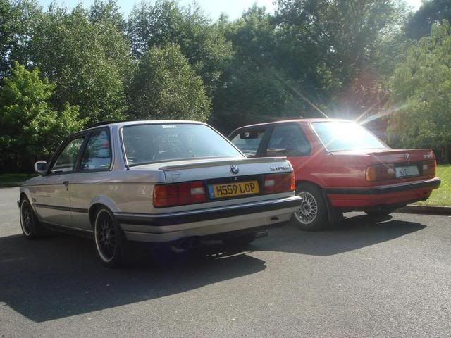

Pictures
How it looked when I picked it up
[/B]
Pictures beside my old 316i-lux

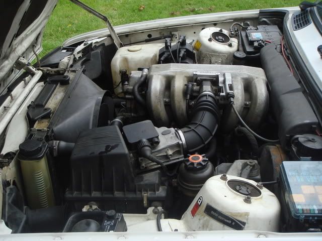

Update:
After seeing Soapytits great progress on his car, I decided this morning that something had to be done on the track car.
First I spent abit of time on the road car fixing the instrument cluster but to no avail
Then the days work began
Started by clearing everything out of the interior and boot (I have been using it as abit of a store for the last 9 months
Cleaned all the boot until it was nice and white again.
Then I tackled the mess that was the sound system that had been in the car when I got it. With great music comes awful wiring
The person that put it in didn't have any sence of organistation, wires and connections everywhere. Even the power cable was running down the same side as the rest of the speaker and Amp wiring
But I eventually got it all sorted out and removed each set of cables. Have a nice bundle of wiring now in case I ever fancy some ICE in my road car

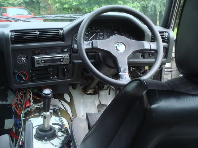

Next job was to remove the remaining part of the dash and try by-pass the immobiliser so I could start her again before the engine came out.
But then Dinner was ready
More work tomoro hopefully unless I remember that I'm in the middle of exams...

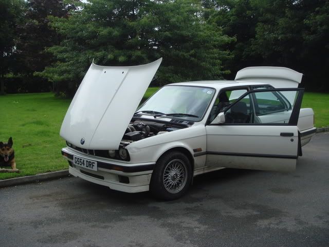

Update 2
A little bit of work this evening.
Took off some more soundproofing I had missed yesterday that was hiding inside the front doors. Pure prick to work around the inner skin
Stripped all the controls and little bits and pieces off the dash and tagged all the loom so I'll know what goes where because I wasn't going to be spending a week with tracing wires when putting bits back in.
Car was also wired for a 13 button OBC so kept that useful loom aside for some Ebay OBC I'll try find
Took out most of the interior parts of the BMW alarm today and tried to find where the imobiliser was going but got a little confused so I abandoned it until it was brighter

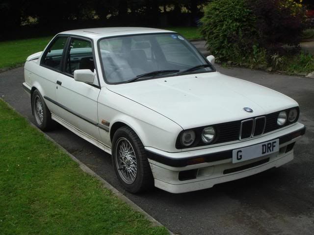

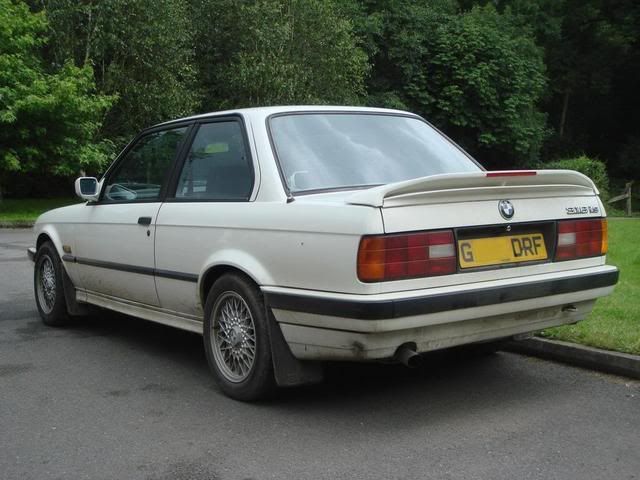

Since I had no tiger seal on hand to attack my smoked headlights today on the road car...
I have "the white one" as she's becoming known as around the house abit more time.
Got off all the headlining (tore it along the way:rolleyes: )
Removed all the sound deadening under the roof.

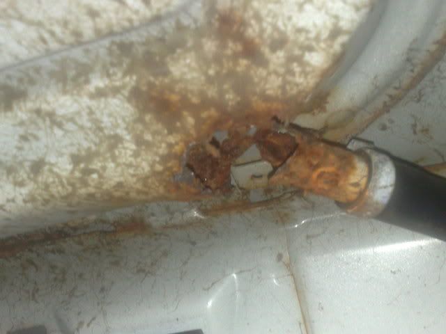

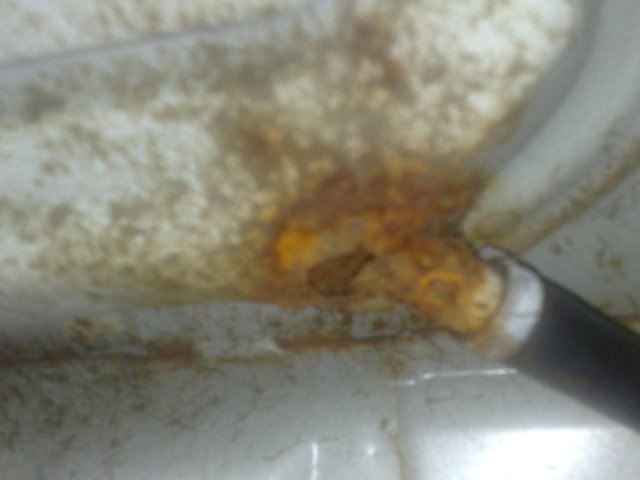

Then, I downed tools when I found my first and only bit of substantial rust:(
After I poked at it... :eek:

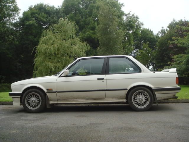

Update 4
Rear axle off tonight since a friend needed one in a hurry to do a disc brake conversion on his 318i.
Just have the engine and fuel tank to take out now and it'll be up on a tripod for blasting and seamwelding
I reckon, I never had a longer stint of bolts being so easy to open. Every bolt on the rear end came undone with one tug of the powerbar, the petrol tank filler pipe came off very easy withoug cracking and then I was pleasantly surprised to realise the petrol tank is actually new
Engine next now to come out but want to start it first since the immobilser is after going funny on me.
Have to bypass that somehow

The E36 M3 Evo 6 speed swap was a walk in the part to do.
Used an M20 starter, flywheel and clutch from an E30 325
Shortened the E30 prop by about 110mm and fitted the larger flange on the end of it to take the E36 box
Shortened the gear-linkages
Gearbox bolts up on the mounts perfectly for a 4 cylinder E30 but only just as if it was 10-15mm longer it would be the same story as fitting it with a M5x/S5x engine.
The E46 M3 6 speed manual was the same in term of fitting but the clutch and flywheel is more hassle as the splines are different so couldn't use the M20 clutch so just threw in the E46 M3 flywheel and clutch for the time being as the one I got made for the M20 flywheel was wrong and not what I specified :mad:
The reverse switch also had to be messed with on the E46 box too as it worked differently to the E30 one.
Used a 4.1 LSD in the car with it last time I had it on the road and it went like shit off a shovel and was very entertaining on a twisty road.
Was as quick as a E36 328 and could drift in 2nd and third gear no problem.
Will be using a lightweight billet S50 flywheel and custom clutch with a 40% 3.91 LSD I rebuilt for it when the car all goes back together as I took it off the road and stripped it for a full restoration not long after I posted this thread... My 328 Touring, S54 track car and customer cars are taking priority though :rolleyes:
E36/E46 rack bolts up fine by mounting the rack on the front holes and spacers above the rack. E28 M5 engine mounts help clearance even more.
