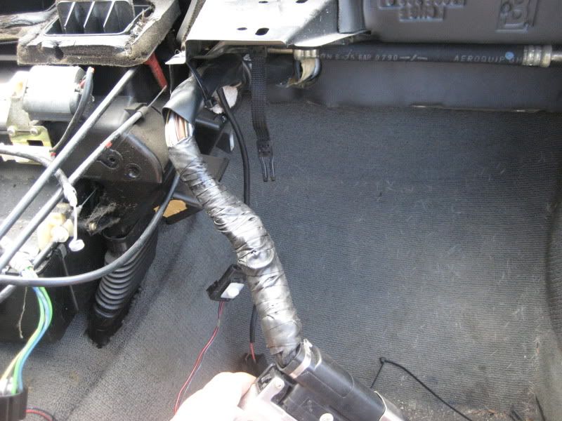

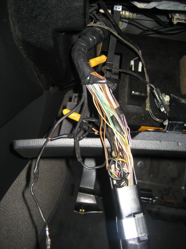

Okay, so now I am totally lost. After a little trying, I pulled the pin from #25. I ohm checked again in various places at DME and back on the wire roughly 6-8 inches. I am still getting variable resistance. However, most of the readings are 0.8ohms which is in spec. But then I got to something strange on the harness. Here are some pics of my harness and my wifes harness.
Mine is nice and clean, no issues
Hers has some yellow caps in the harness which are not in mine. Our cars are them same build date 06/90 and all original in the wiring department. The only electrical difference that I am aware of between the two cars are the tweeter speaker by the side view mirrors. So what the hell is going on in this pic? I figured the loom should be identical...

So prior to my previous statement I assumed I didn't have those yellow connectors in my harness. I assumed this because her harness had the connectors clearly visible before removing the tape. My was not that way. So I opened it up and I have them too. This leads me to believe one of the harnesses has been opened in the past. Either way I'm at a loss for the readings I'm getting. Going to BMW to buy the connector in the morning.
