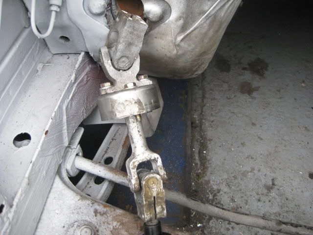

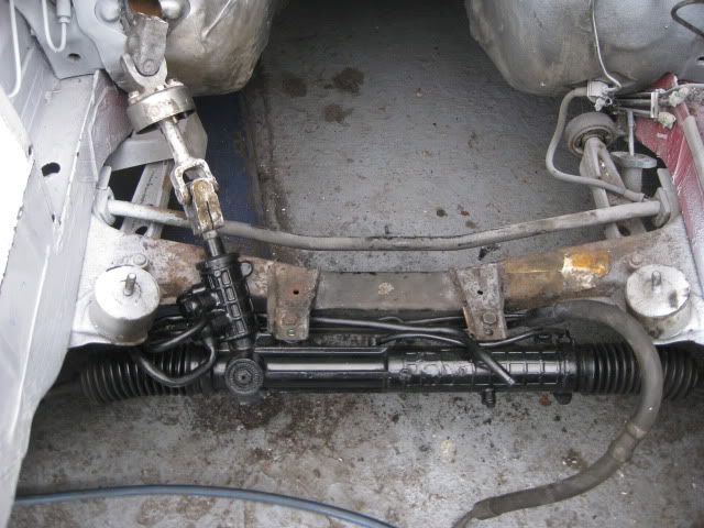

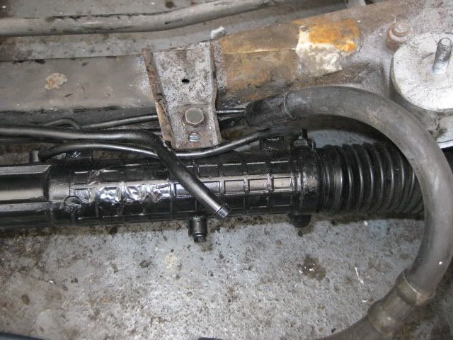

I have done it on a Uk spec E30 and used the E30 pump and top half of the steering coupling You have to use the bottom part of the E36 steering coupling at its a thiner shaft
OLD E30 RACK AND PIPE SET UP
NEW E36 RACK AND COUPLING AND SAME E30 PIPES.
