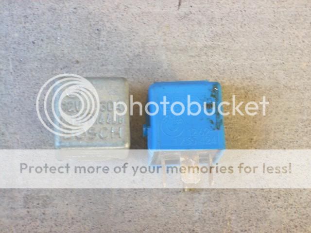

Quote from: thunder39;77604
Just checking in.
Good deal on fuel pump relay? Or is it the wrong product.
http://www.partsgeek.com/gbproducts/YN/D938-KAE-P2037.html?utm_source=google&utm_medium=ff&utm_term=91+1991+BMW+318is+Fuel+Pump+Relay+Kaehler+BMW+Fuel+Pump+Relay&utm_content=YN&utm_campaign=PartsGeek+Google+Base
Here is a picture of two that have worked in my 91 318i. They are four-terminal relays.
