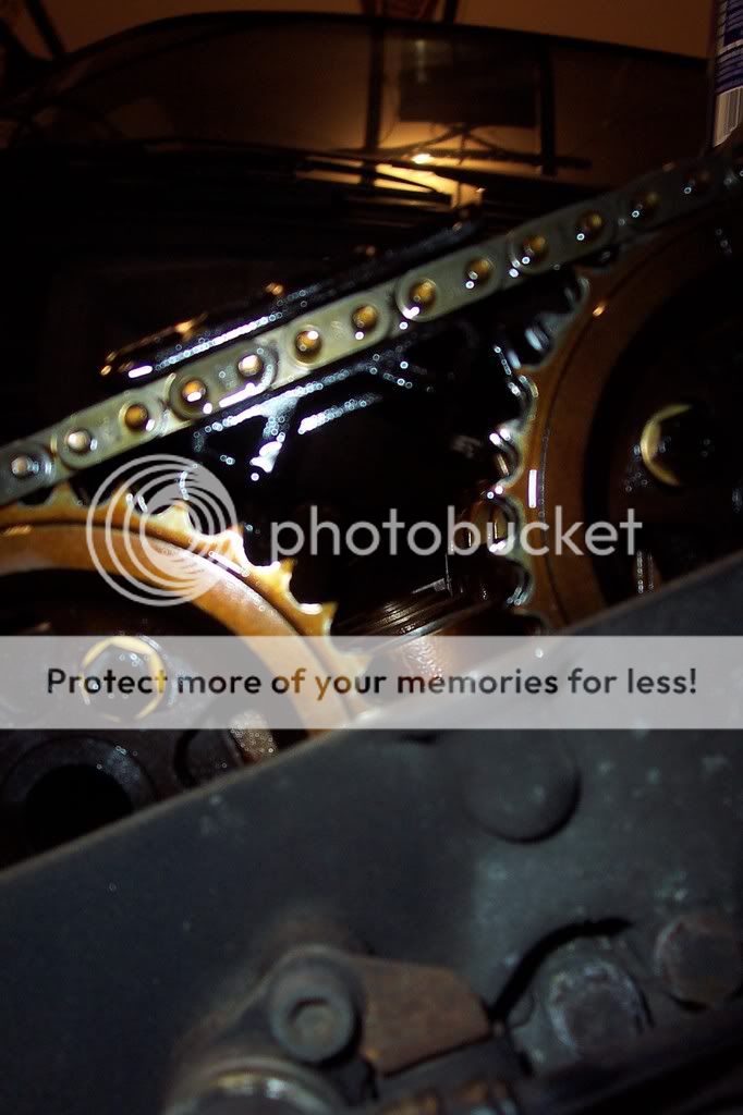

it all started here:
chain pieces in the oil pan... not good
and then...
worn sprockets.

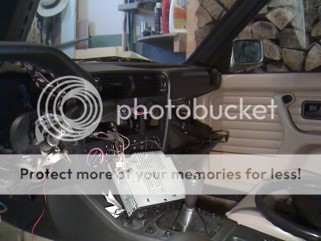

the weekend i came back to fix the chain issues, i had news that the car was brain dead. huge electrical problem and about nothing worked. got tired of poking stuff around and decided to just take everything apart and then put it all back together... and it worked!
once that was solved, i could finally tackle the chain issues! pics of the work...

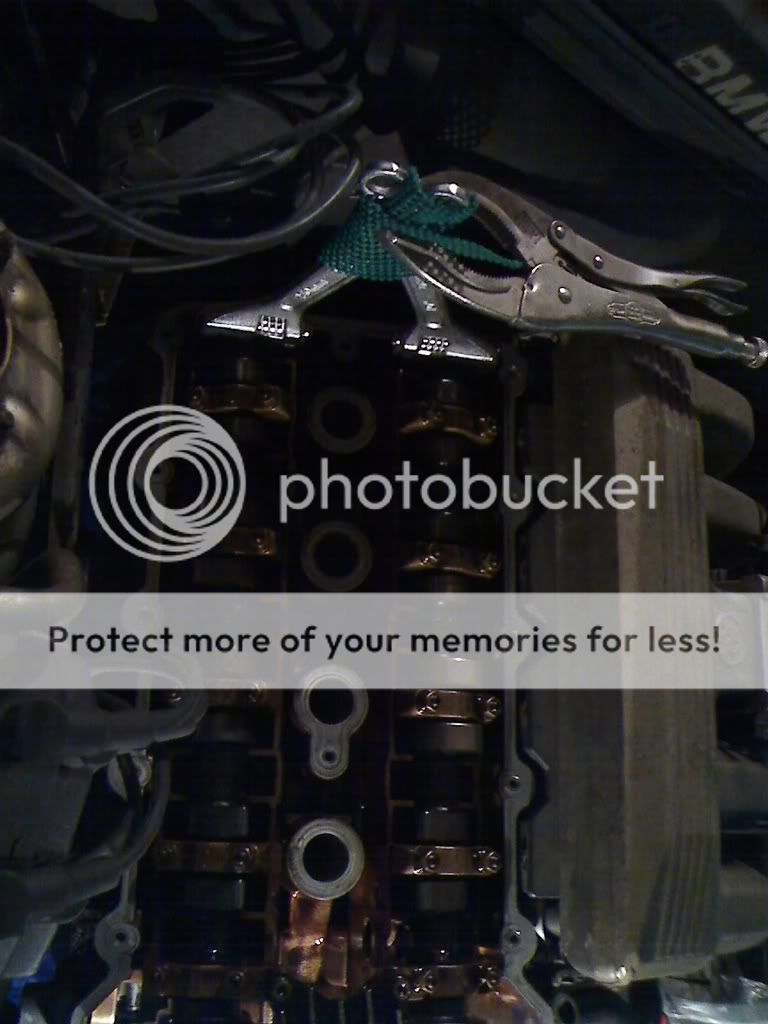

simple yet effective cam locking tool

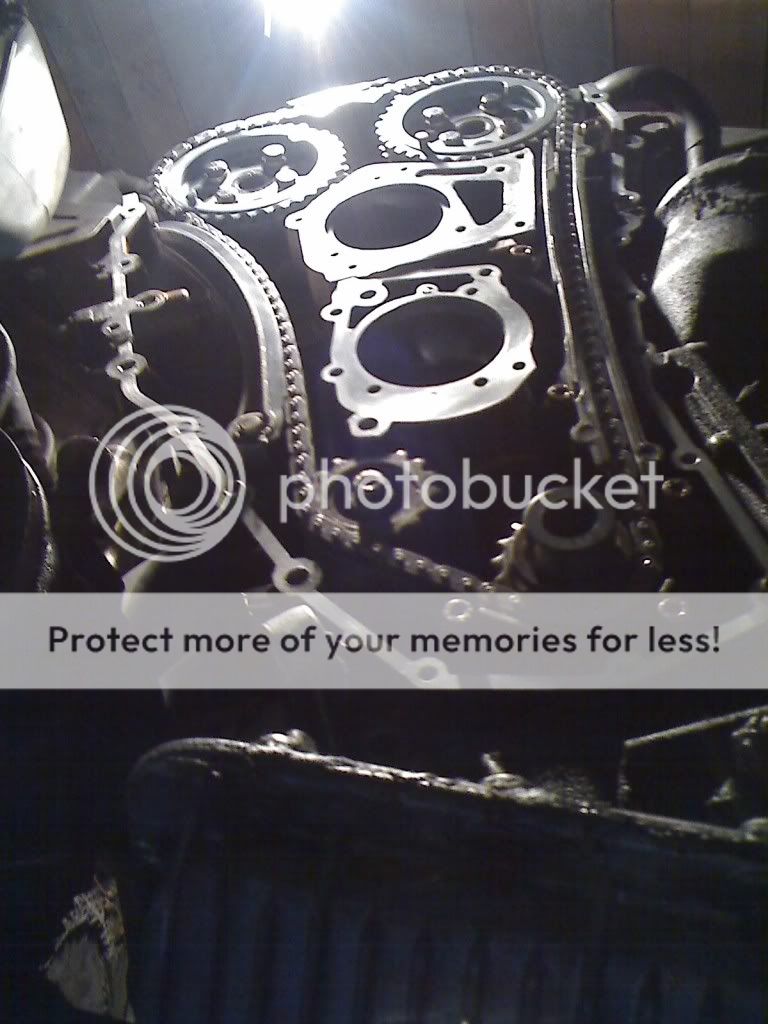

stripped down timing case

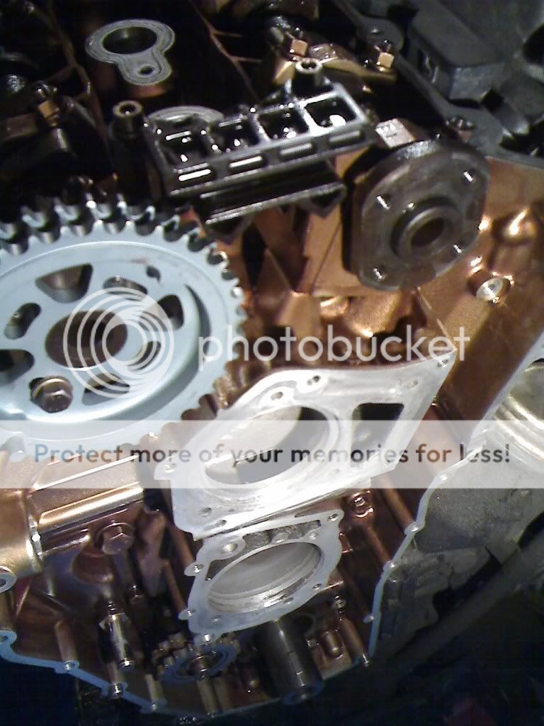

a new sprocket in. when i got them, 1 of the sprockets had it's pin sheared off! so i took the 2 old sprockets and the bad one to my local tool store and they just pressed out the rest of the sheared pin and replaced it with a pin from the old sprockets... and it works great! no problems at all!
all the new pieces in.
