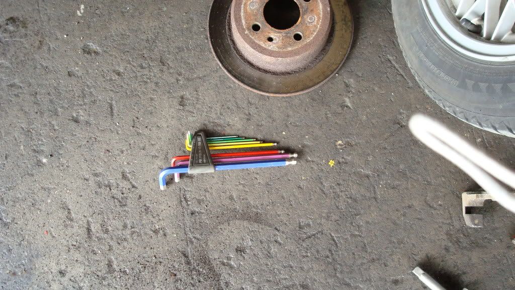

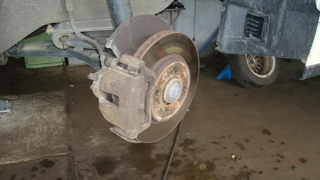

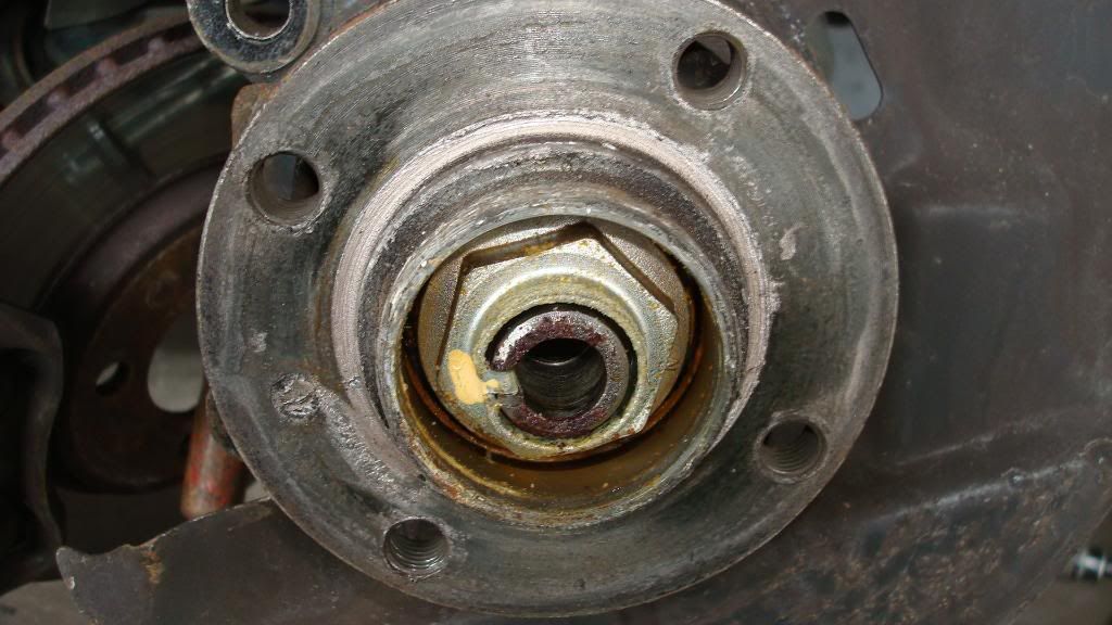

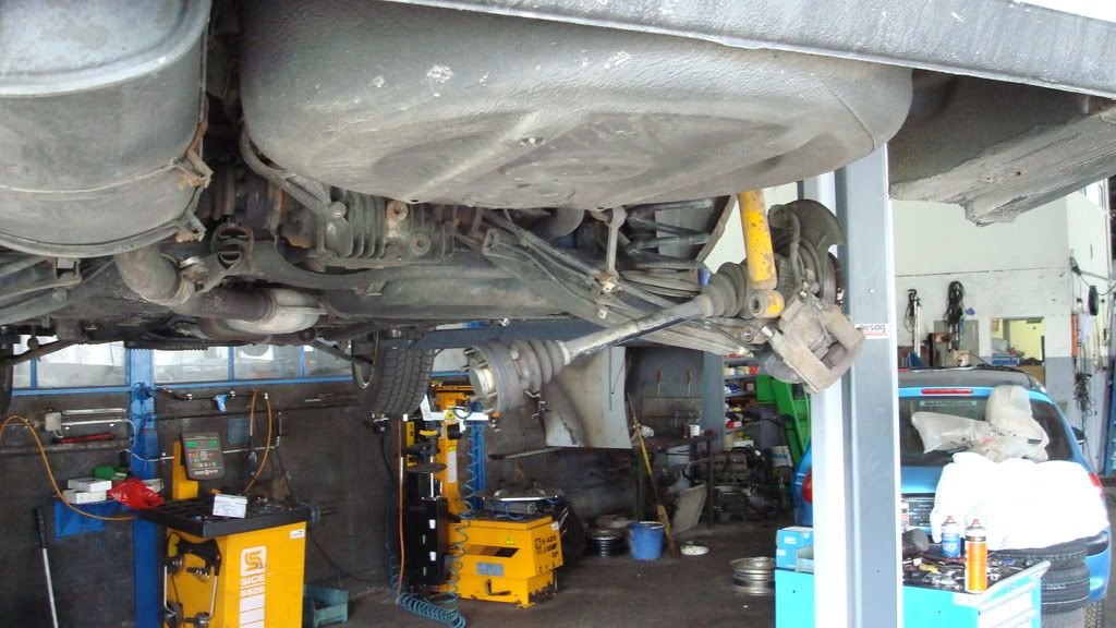

first the wheel bearings...
remove the brakecaliper, the brakediscs, the damper and the output shaft..

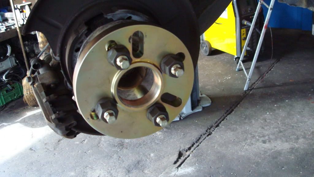

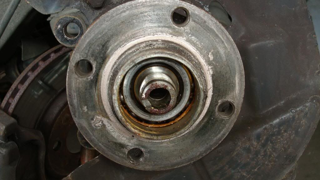

then the luxury version...
the easy way to remove the hub...

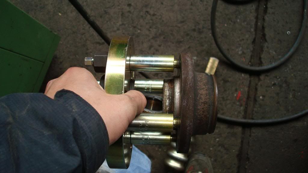

April 07, 2008, 10:18:18 AM »

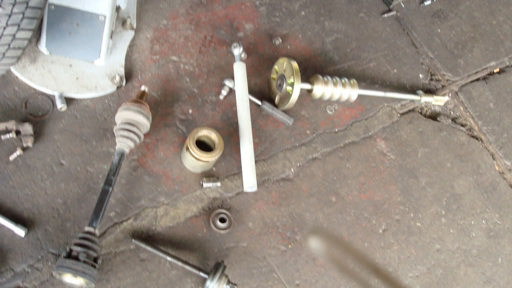

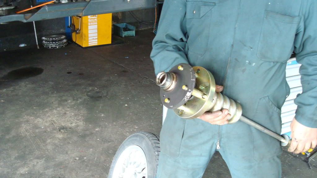

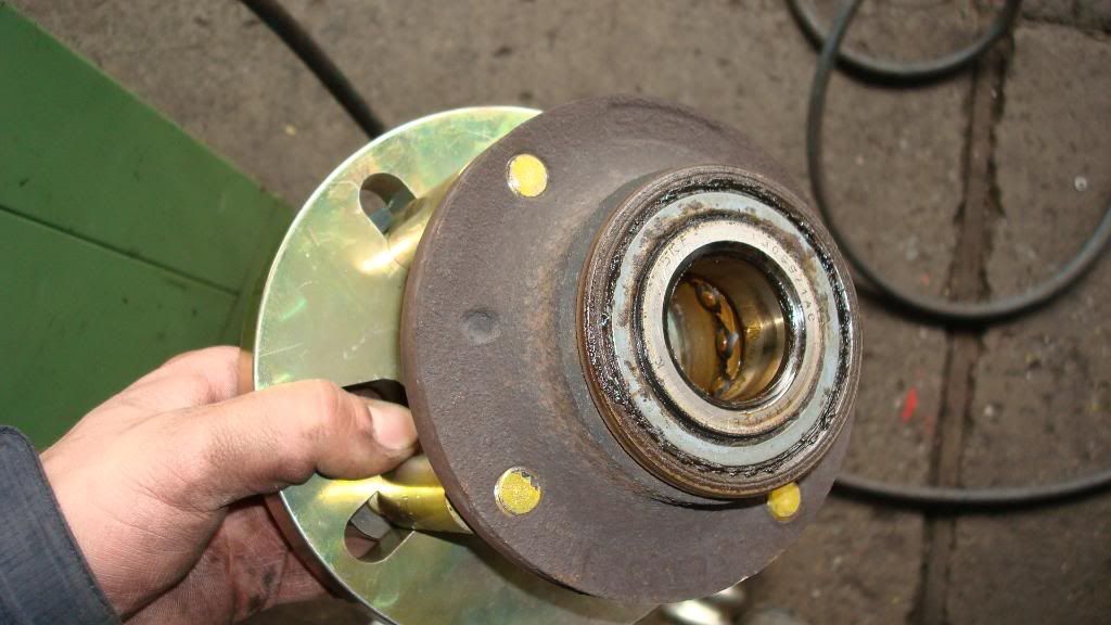

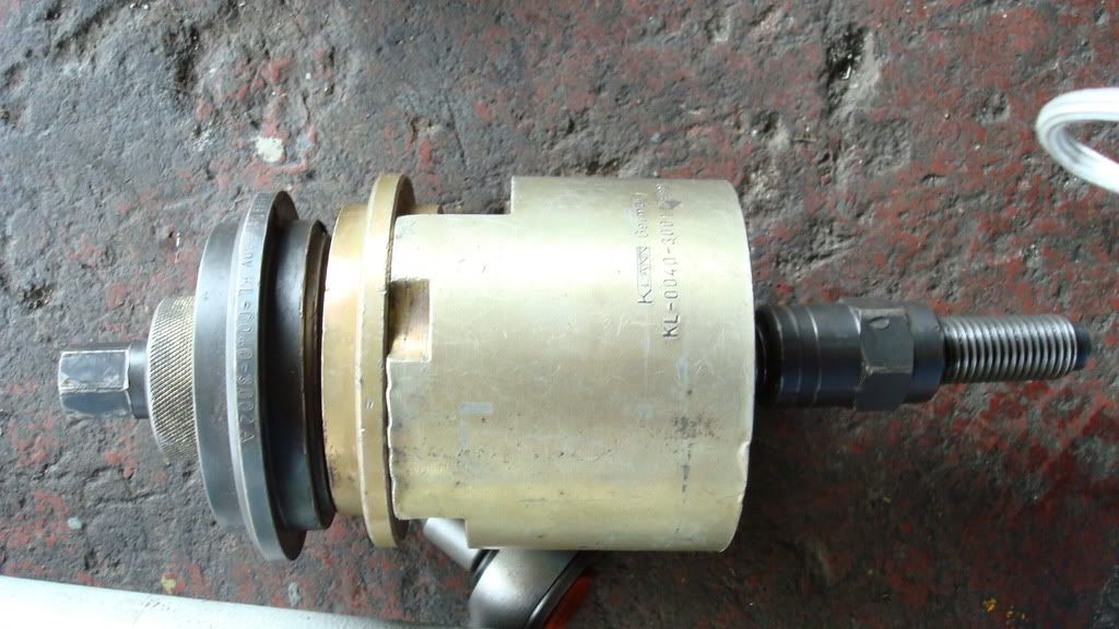

with this tool you can remove the bearing with pulling it out ... the same tool is used to push in the new bearing and the hub..

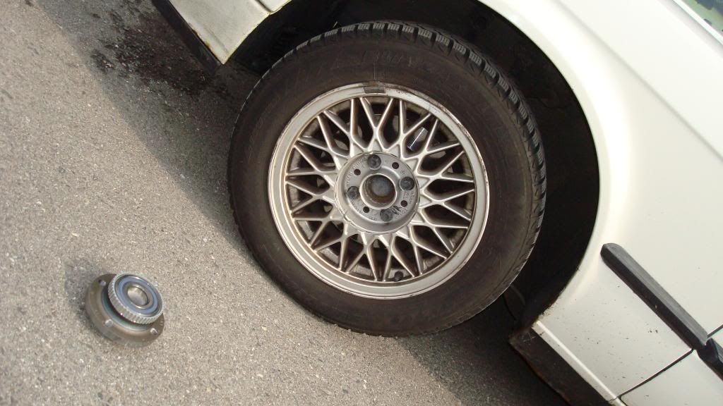

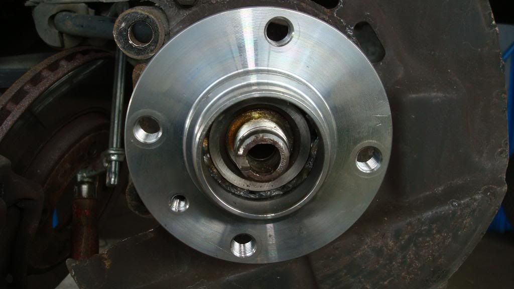

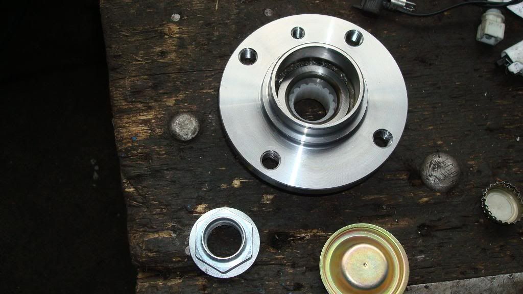

front hub change...
Hero Member
-Receive: 1
Posts: 862
rear rubber mounting and wheel bearing replacement
Reply #22 on:
April 13, 2008, 11:53:22 AM »

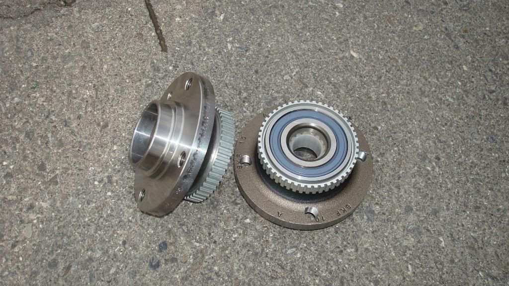

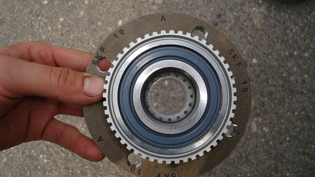

the hub-set...
Hero Member
-Receive: 1
Posts: 862
Reply #23 on:
April 13, 2008, 11:55:43 AM »

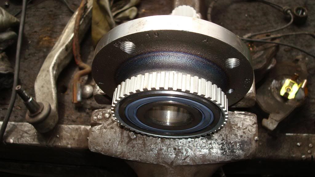

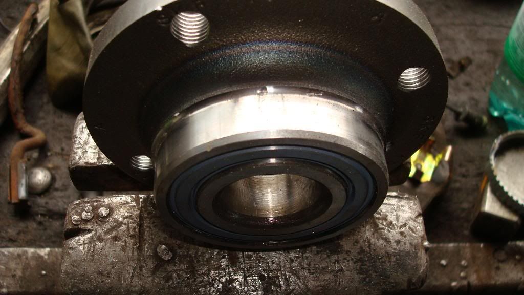

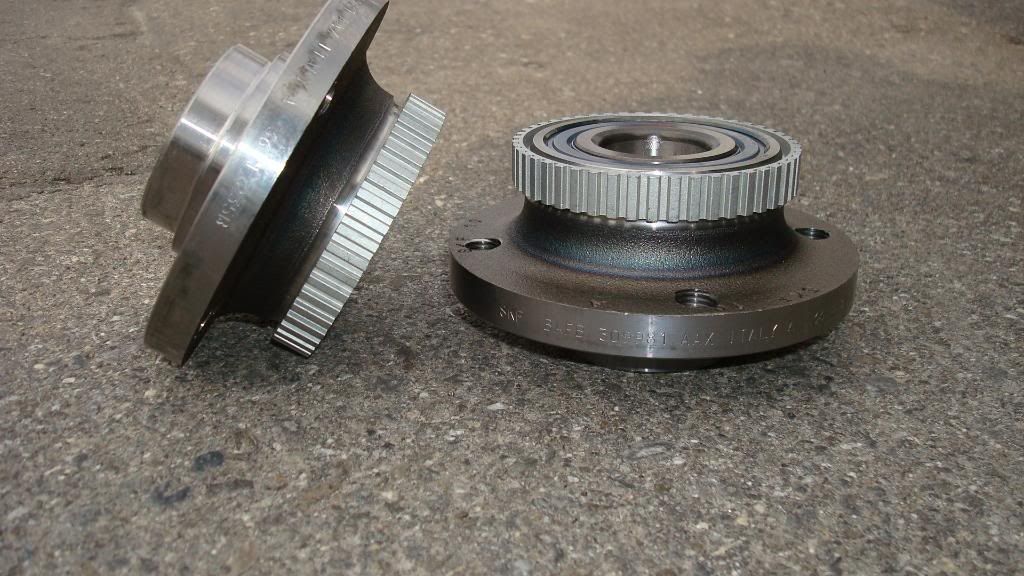

because the stupid quy on the phone where we order the parts dont know the different between ABS and NO-ABS hub...i have to modify the hub before assembly..
removing the ABS ring...

April 13, 2008, 11:57:25 AM »

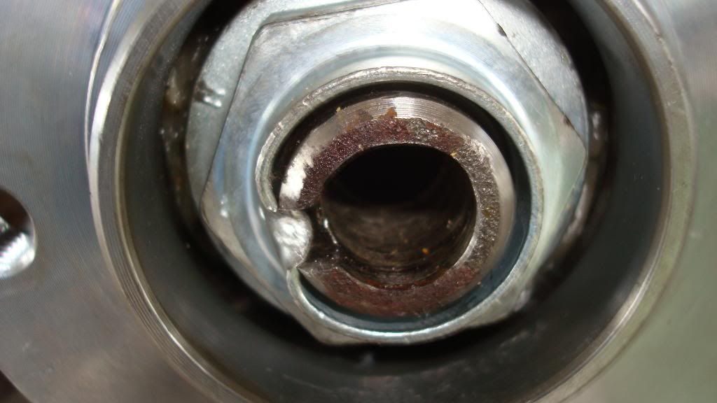

then remove the front-wheels..
then remove the nut which holds the hub...

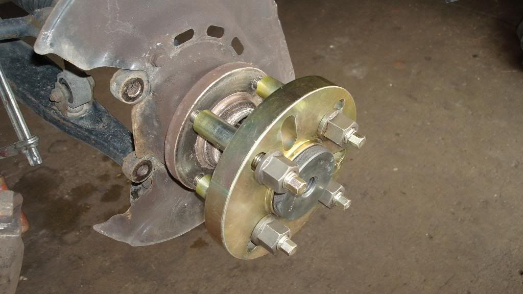

April 13, 2008, 11:58:42 AM »

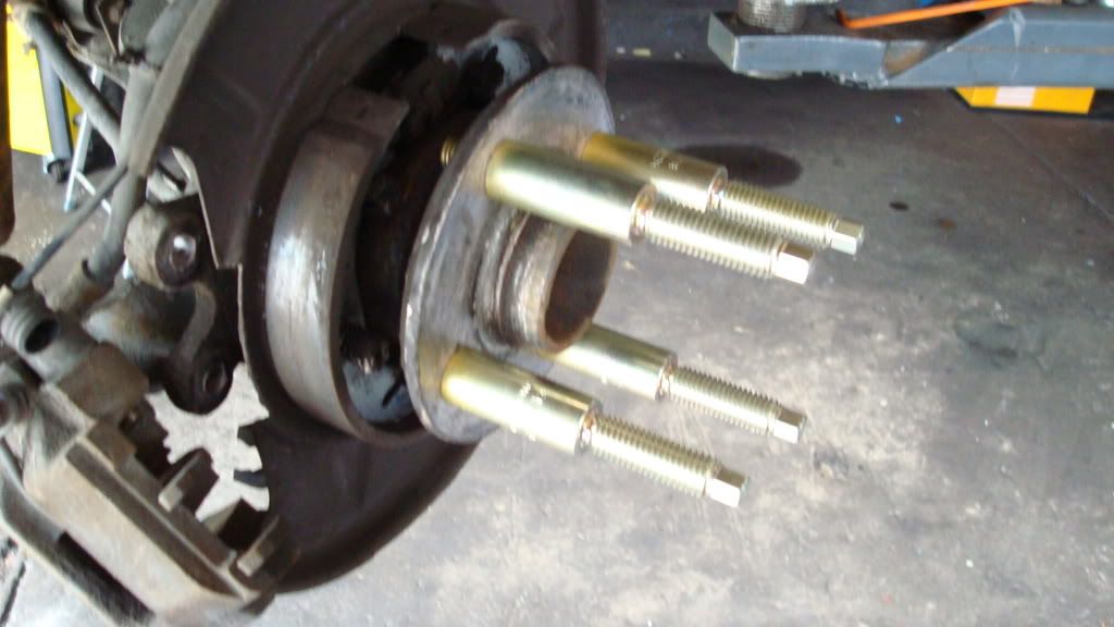

i removed all the hubs with an adapter and a slidehammer..

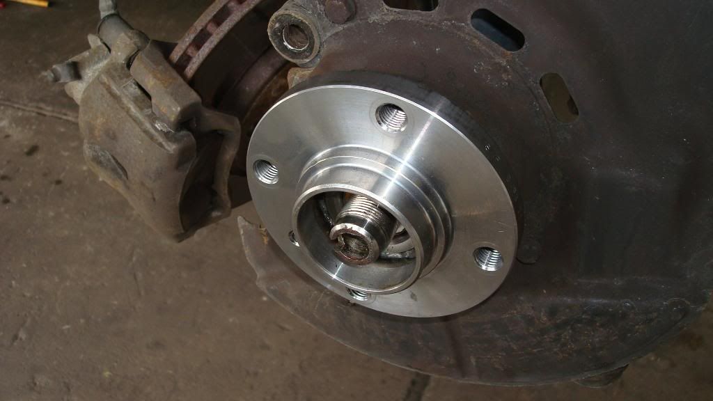

April 13, 2008, 12:00:30 PM »
after that the new hub.. some shiny blingbling..
thighten the nut and fix it ..
