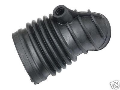

I dont have access to a press.  Can I manually replace the bushings, or do they need to be pressed in?  I believe they look like this:
Any info would be appreciated.
