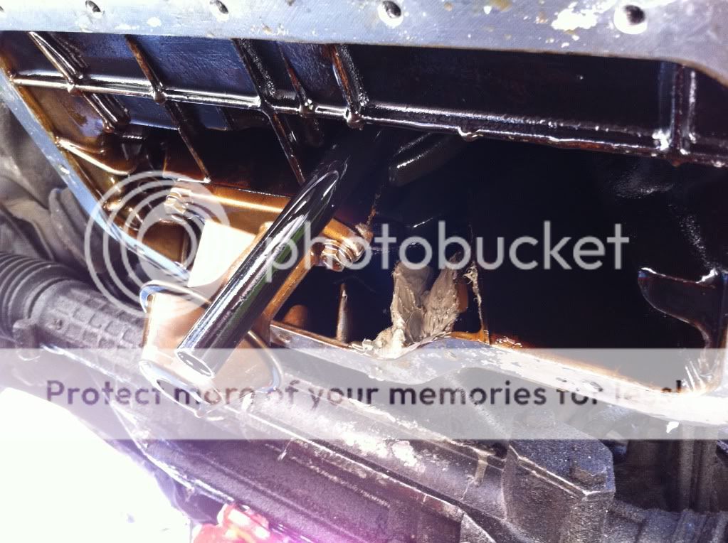

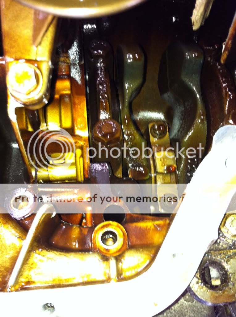

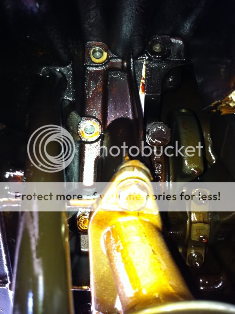

after getting the car started due to electrical problems i let the car idle and the oil light came on. the cars sounds like a ups delivery truck so i amused it was the lifters getting stuck because the car has been sitting for a long time (over 6 months due to connecting the batter wrong). however after letting it idle for 5- 10 minutes with some revving, the sound and oil light didnt go away. i was going to pull the oil pan anyways to see if there was any loose bolts and this is what i found. let me know what you think i should do.

it looks like all the bolts are missing, and sealant on the upper oil pan in the last picture? the crazy thing is there are no bolts in the pan!! is it possible the bolts flew up into the crank?

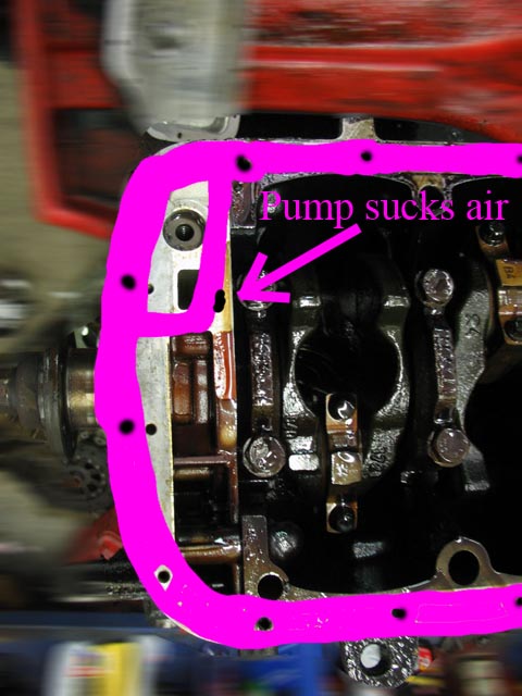

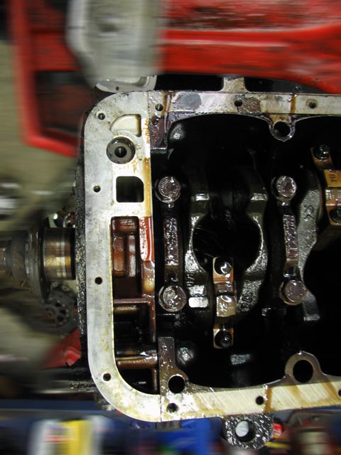

For some reason, it is somewhat common for those upper pan bolts to fall out / strip. When that happens, the upper pan-to-timing case gasket can implode around the oil pump inlet & suck air. Your oiling system has been running dry, and you should not run the car for another second until you fix this.
I believe that the bolts are M6x18. Figure out if anything is stripped. If so, fix them with helicoils or other repair inserts. Use Loctite when installing the bolts. You'll need new oil pan gaskets.

just got done cleaning the area where the upper pan meets the block and i can see the upper gasket sticking out into the open. very similar to the picture i posted. looks like i wont be able to cheap it out by just replacing the bolts.
