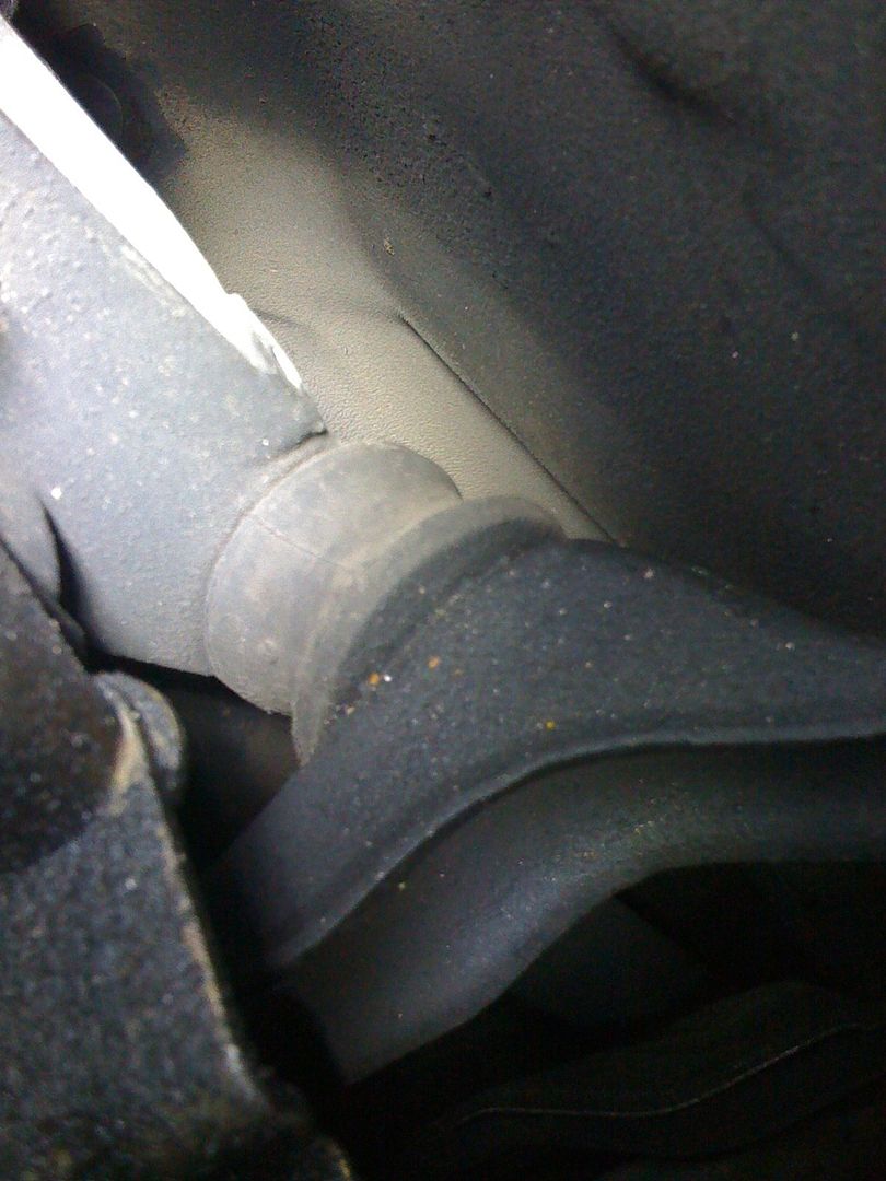

« Reply #11 on: March 03, 2010, 08:44:11 PM »
Well here are my mounts... They look ok, I guess. The rubber is a bit cracked but they don't look twisted or broken. The do feel a little gooey, and I can leave a mark with my fingernail. The tranny is covered in oil too, but I checked the level and it seems to be fine. I guess I might have just worsened the situation with my attempt to shift into 3rd at 6k rpm. Damn I think I'm really left with no option but to change out my transmission. Hopefully this weekend's autox doesn't leave me stranded...
What do y'all think about upgraded mounts. I've read there are some vorshlag mounts that are super stiff and help with performance driving. They're pricey, about double the price of stock mounts. Is it worth it?

When mine were bad, I put a jack under the trans case and lifted a little and it became apparent the the mounts were blown- explaining the "wham! wham! wham!" driveshaft hitting the tunnel sorta thing I was experiencing when the, uh, driveshaft hit the tunnel off throttle.
[SIGPIC][/SIGPIC]-Scott

I'll try lifting the transmission a bit and see what it does.
For the mounts, IE mounts Urethane $49.00ea vs Vorshlag 70A for $250/pair. Worth the difference? How about IE Tranny Mounts for $70 vs Vorshlag for $89? Are tehy basically the same thing?
