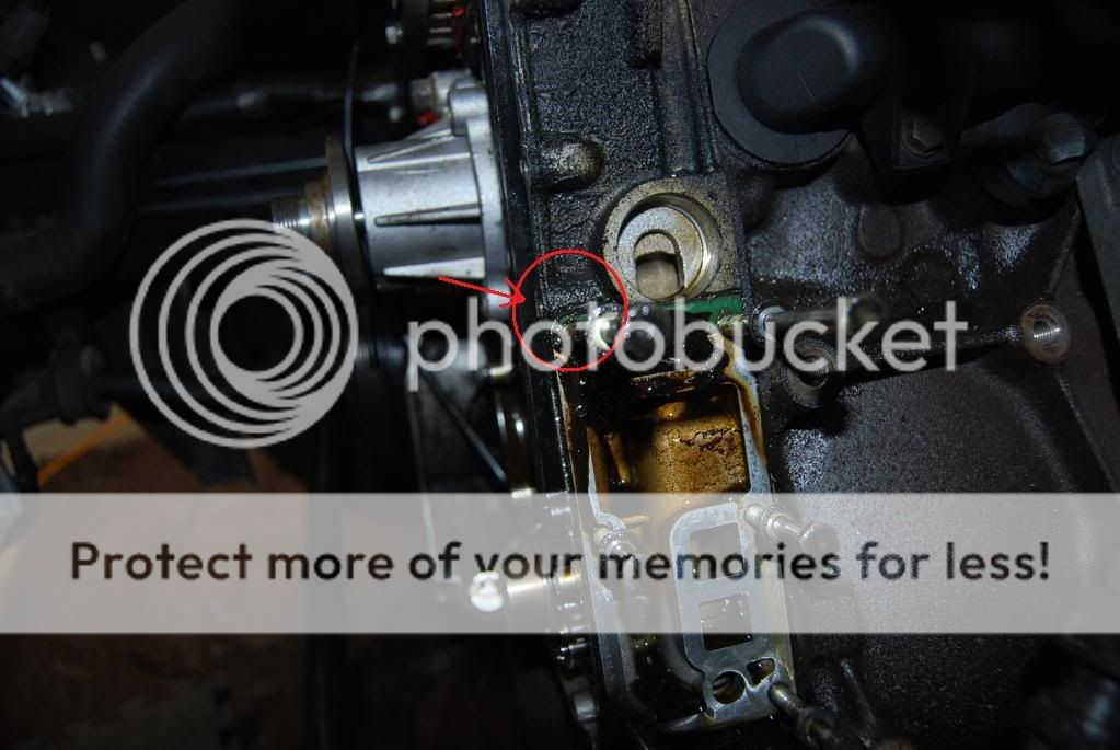

Carl, could you tell me what bolt went there??? and also, does it hold anything else than just the timing cover? passes through to the oil passage??
i've got a good oil leak from that bolt (still wondering what happened to it, it's not there???)
thanks!
ps: thank you for the excellent picture that i stole from you:D

« Reply #32 on: April 13, 2009, 08:10:40 AM »
B318M42,
Yes, thats one of the bolts that hold the oil filter housing against the timing case. As you see in that picture there. There are 6 bolts. The two at the top are very long. If it is missing, there would definately be a oil leak.

« Reply #33 on: April 13, 2009, 10:48:30 AM »
thanks! found a new bolt and put it in. hope it stops leaking :D
