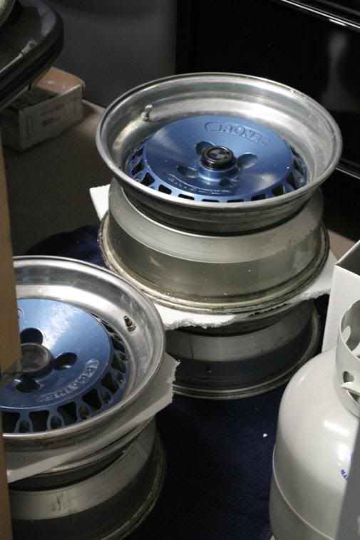

I have 15x7" ET13 MiM 1800's
A staggered set of Ronal Racing 3 piece mag wheels 15x8 ET-6 out back, ET 12 up front.
A broken down set of BBS RS wheels, hopefully 15x9 all the way around.
Opps, forgot to mention it's an E21.  Standard fitment is ET 13 on a 7" wheel for my model.
Ronal, centers are out for powder coat, not a fan of the blue:
MiM's:  In need of work:
Center caps I made for the MiM's:
I'm a wheel whore.
