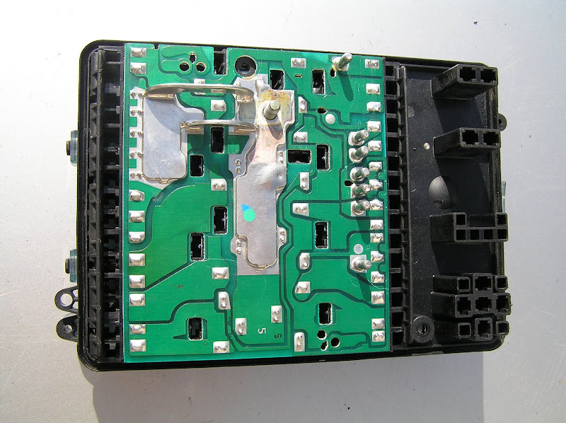

I notice that the fuse box has one or two open circuits (nothing is operated by those spaces). Has anyone over hardwired anything (particularly a radar detector, but anything will work for suggestions) into the fuse box? I was going to check how much the detector drew (since it runs off the cigarette lighter, it probably takes a few amps) and try to hardwire it in there.
Am I correct in thinking its easy as 1-2-3? Just disconnect the negative, undo the fuse box from the body and connect the positive and negative wires and input a properly amped fuse (ex. 7.5, 10, etc.)?

Nope, not that easy. This is the bottom of the fuse box:
You should have a small auxiliary fuse box off to the side that you can use, though.

« Reply #3 on: September 08, 2007, 01:12:49 PM »
there are other ways to hardwire a radar, and still have it look and function profesionally. For example you could run a relay off of the radio "turn-on" wire and run a fused link to the detector (there are many other ways to, going off the fuse box is probabally your most difficult way).
