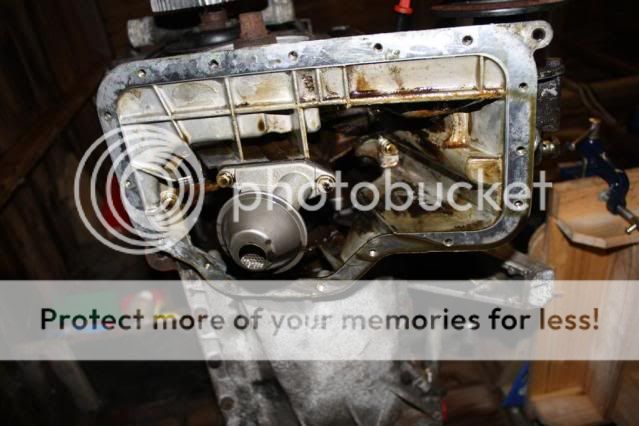

does any one have this pic but of an m42 out of an e36. this is an e30 pic
http://i886.photobucket.com/albums/ac61/VisionRacingDevelopments/Sump/IMG_5921Large.jpg

The e36 oil pan has the oil pick up tube built into it so even though the sump is at the back the oil pump in can remain in the same spot on the block. look at post #10 in this thread.
http://www.m42club.com/forums/showthread.php?t=4935

i am pritey shaw that not in a bmw i can use the e36 sump on my e30 engion. just looking for a sump and oil pick up.
