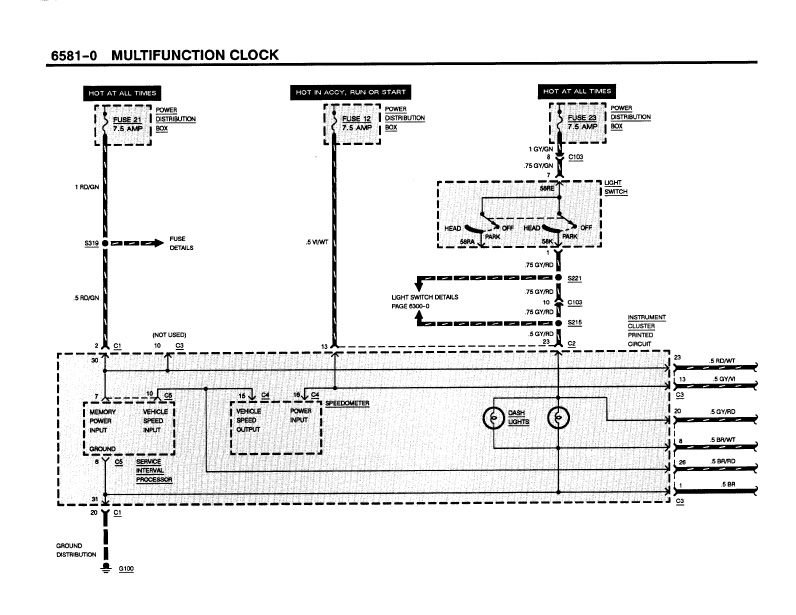

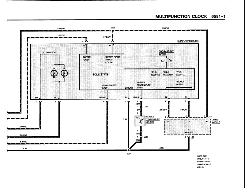

Didn't we go through this in May?
Here, try this:
Don't know what else to tell you - if your car came with the 6-button OBC, the wiring was originally there. If it is not now there, then there is little we can do about that...  you'll have to add the wiring back in yourself. Or put an analog clock in.
