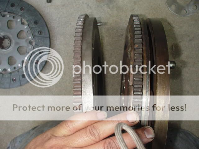

Here's the M20 Flywheel I installed two weeks ago.  Next to it is the M42 Dual Mass flywheel it replaced.
