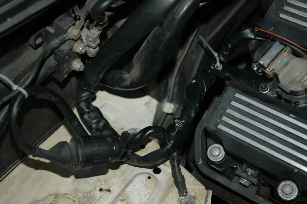

installed and looking great, here are pics for you to help advertise
-mA+t B

« Reply #42 on: August 23, 2009, 12:01:01 AM »
just got mine in today....my thoughts, ...well worth it in my car...thanks...
been fighting a slight miss  during hard acceleration for a few months,
installed coils, wires, no difference ( swapped from my parts car)
installed cop kit, did not notice a difference at idle, but sure did under heavy acceleration
my combo, 4 point injectors, chipped, throttle heater crap gone, K&N in stock box ( came with car)  delete fan a/c &p/s.., 2 1/2 exsaust and magnaflow......now wiht this cop kit, pulls great
install, note for me anyway, the wires go in a lot easier with the "top" ( intake side) bolts out, wires clip right in, install all bolts to align, tighten bottoms,  then remove  uppers , plug in wires,  re-install  the tops bolts
takes a whole extra 15 seconds, but like I said , made attaching wires a lot easier
spent a few more minutes and ground off the rivits that hold the old coil brackets  to the body, so now those are gone
hey matt, looks good, but mine looks prettier  :)  :)
« Last Edit: August 23, 2009, 12:05:13 AM by 3bvert »
