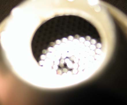

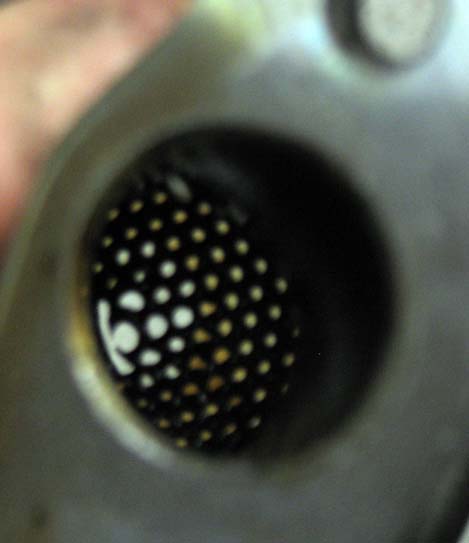

Well, I do take back what I said about the screen, it does seem sufficient in strength, I could not flex it with my hand. That does not change the fact that a peice of timing chain went through it! Makes you wonder what kind of suction is actually going on down there to be capable of that.
Sorry so blurry, it was hard to get decent pics.

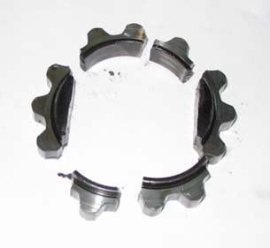

Here is what is left of the inner oil pump ring....
Boom!
All the kings horses and all the king's men... yeah, yeah, yeah, them fuckers could not put this peice of shit back together again either!

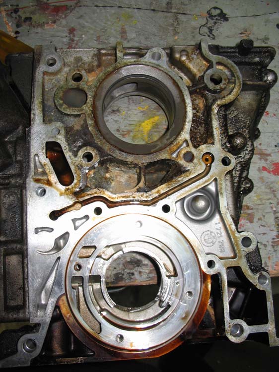

Here is the outer ring, still in the housing...
It is seized in there, it took a bit to get it out, as you will see later.
The arrows pount to destroyed teeth from metal getting in between.
Here is an interesting shot:
Arrows 1 and 2 point to cracks in the housing. They are stress cracks from how tight the outer ring was pressing against it. It was so tight when hot, that on each side of each crack, the part is warped. There is still more to see of how bad this truly was in the next picture.
Arrow 4 shows how far around the cracks went. 3 points to the uppermost area undamaged. Odd, since just below that is a rib, hower it cracked the rib and left this. It did still score it though. Look at teh gouges all the way around.
Here we have the misc. parts of the oil pump. The big ring is the oil pump backing plate. Notice the chunk missing!. That lines up with the 2 cracks in the previous picture. You can see the ripped out part just to the right of it, it looks like a washer. Look at the scoring on the back plate.

The destruction was certainly caused by the timing chain roller(s) getting through the pickup screen, plastic could not do this. What caused the chain to destruct is partially open for debate. The chain was certainly in bad shape due to being run too loose. The second half is that changing the tensioner while in the condition it was in, may have acclerated its destruction. For those wondering, there was nothing ever came out in the oil (I watched and listened for anything) and nothing was in the filter when the oil (and filter) was done just before (2000-3000 miles previously). The tensioner had been in for maybe 3000-4000 miles. It may have also just decided it was time.
