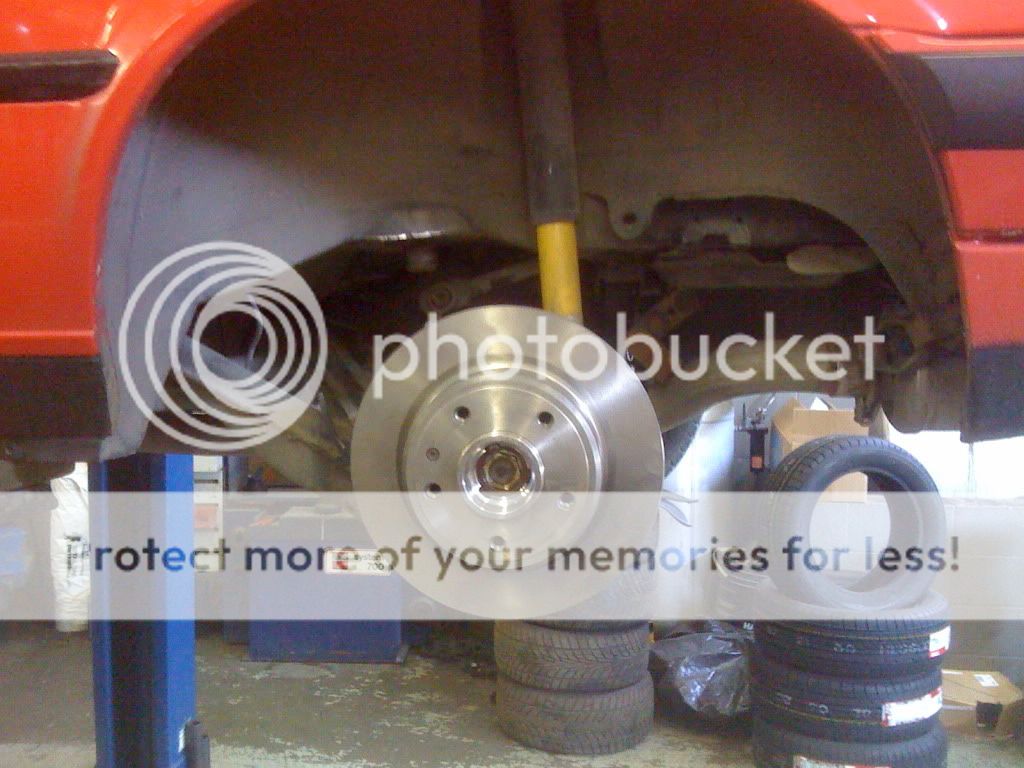

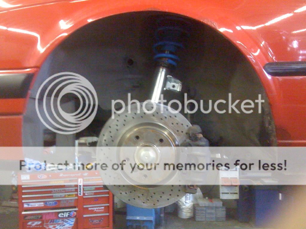

« Reply #50 on: May 07, 2009, 07:03:10 PM »
Started the swap today got the fronts done. with the bilstien coilovers m3 control arms and offset bushings you will not need camber plates it fits just fine with out them i do not know if this is the same for regular strut set up though. will have pics tomorrow for wheels up front im planning on using a 18x8j with et47 they fit like they were born there hopfully the rears will work........

« Reply #55 on: May 22, 2009, 07:14:02 PM »
Ok finally had some time for pics and to finish one rear side sort of still have to put in the new shocks and springs.

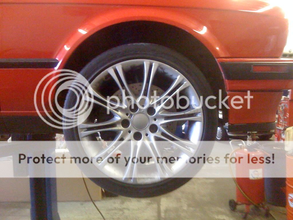

« Reply #59 on: June 05, 2009, 11:26:48 PM »
No i appreciate the ideas allways like new things. i will post pics once i take them im done the swap. im running 18x8 et 47 in the front and 18x8.5 et44 in the rear with 225/35/18 all aound and there is no rubbing only when im at full lock on the steering otherwise its mint. the ride with the e36 m3 coilovers is amazing its stiff but not teeth rattleing stiff very nice ride i would reccomend this suspension to anyone even if you get the set up for the car you will not be dissapointed!!!!!
