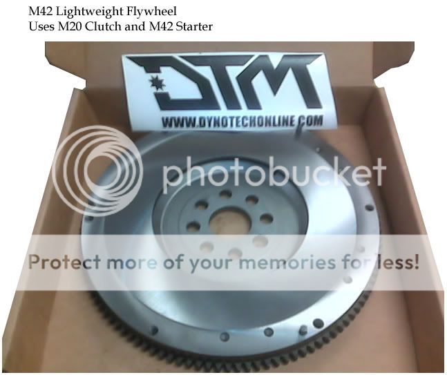

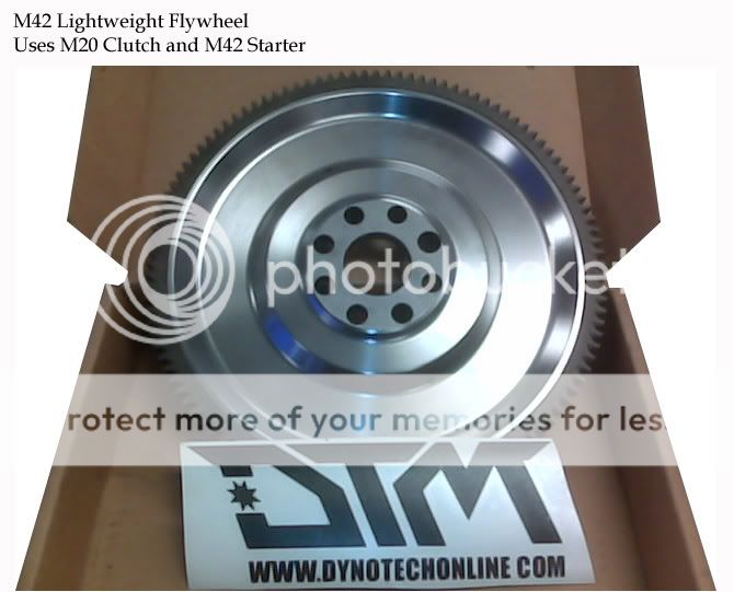

heres another item on the car i forgot to mention.  we do the m20 lightenbed flywheels and swap the ring gears so they are PnP for m42 as well. threw this in with a stage 3 m20 clutch.
might tack on a few extra bucks to the build for this setup as well.
I sent you a PM a couple weeks ago asking how much this flywheel is but no response.
I figure this will be a better way to find out.
So how much for just the flywheel?:)
longms
  • Posts: 352
dynotech motorsports budget turbo build
« Reply #145 on: January 26, 2010, 09:08:30 PM »
Quote from: Awgy;85603
flywheel is $250
stock m20 clutch kit is $195
upgraded clutch options go up from there
flywheels are also 12lbs for the m42 application
Figured I would save him the time and post this up. He posted it up in the middle of the thread. I only know this cause I just read the entire thing. The flywheel works with the M42 starter and requires an M20 clutch. Not sure about T-Bearing though.
Hope this helps

Quote from: Awgy;85766
Thanks,
I read the entire thread when I was building my setup. I thought I saw a price once but couldn't find it again to confirm it.
I wonder if that setup is completely plug and play though?  I am in need of a clutch fairly soon, but I've read so many conflicting reports about what the m20 kit needs.  Longer flywheel bolts, some sort of spacer etc. etc.  If that kit is plug and play completely it would really spike my interest.
e30guydownunder
  • Posts: 171
« Reply #148 on: January 27, 2010, 07:39:35 PM »
You need shorter flywheel bolts (the single mass M20 ones), and the spacer you need comes on the flywheel, you just have to put it between the flywheel and crank instead of the bolt heads and the flywheel.
I used the M20 TO bearing that came with my clutch kit, no issues what so ever.
