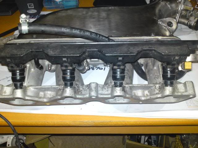

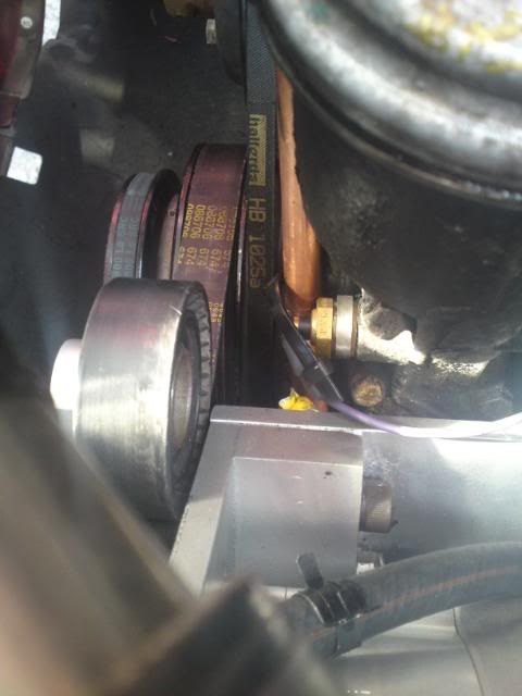

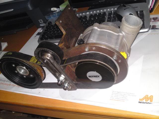

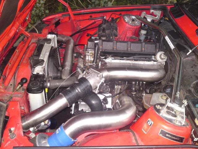

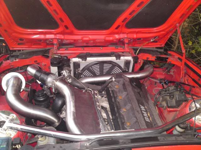

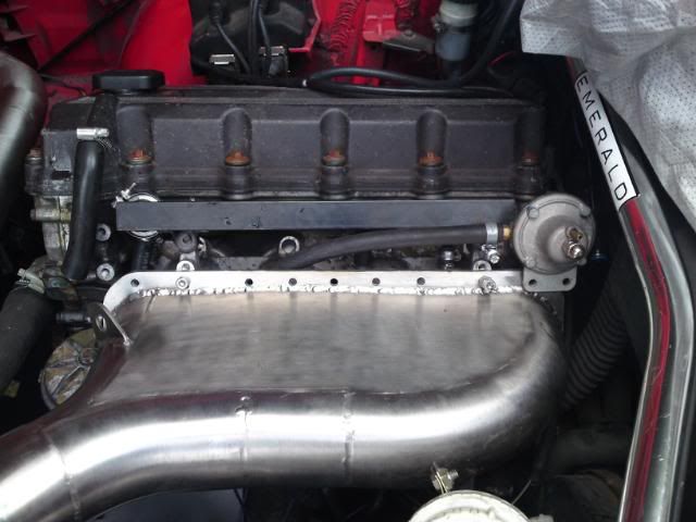

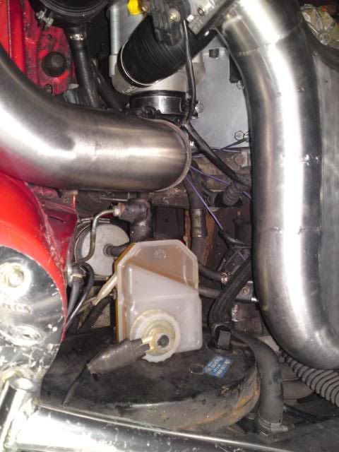

Bit more progress over the last two weeks or so firstly i finished off making the tesioner, ive used an E36 m43 idler pully which also donated its crank pully to make the charger pully so its should be rated at the same sort of rpm/power.

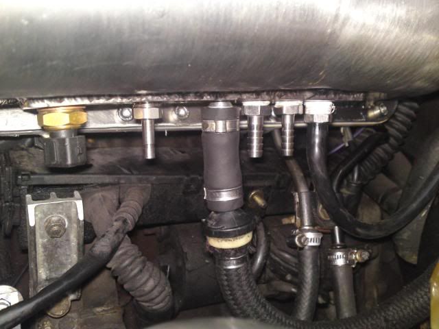

Trail fitted the inlet manifold today and worked out were the FPR will fit, fingers crossed it wont be need after its mapped and it will run fine on the 3bar reg but it gives me the option to play about if needed.

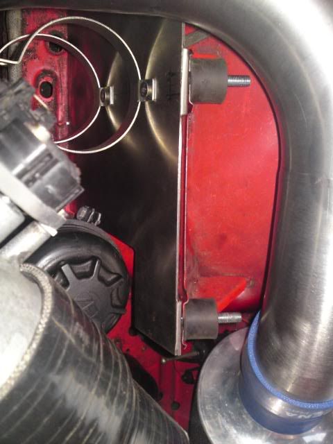

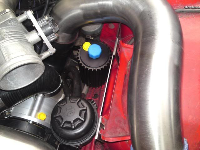

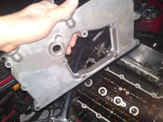

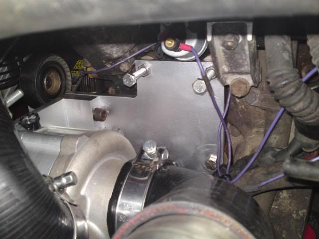

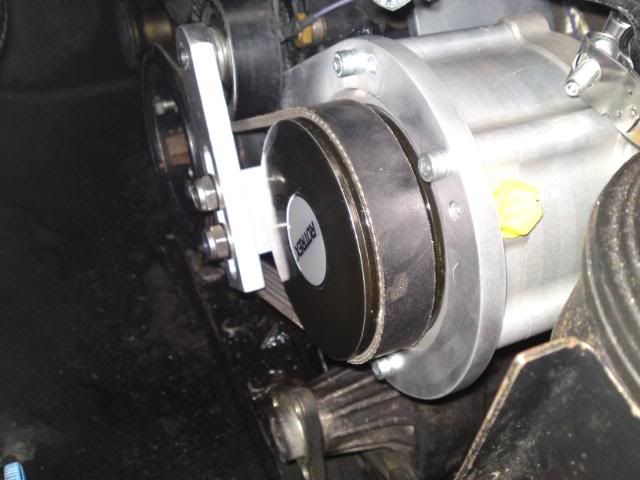

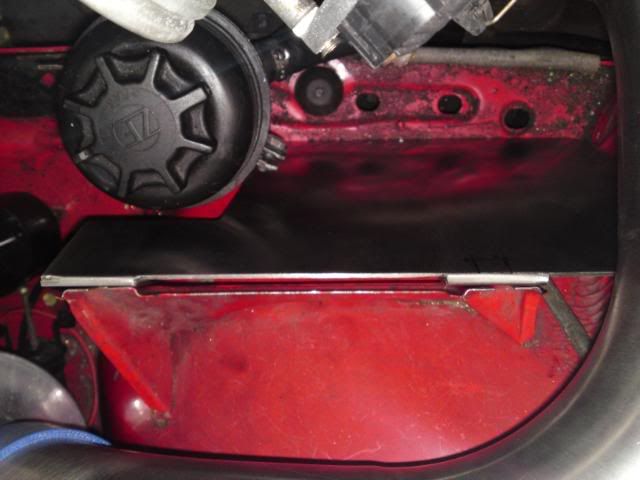

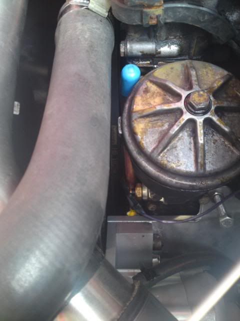

Made this plate to bolt up to old air box mounts so that i can mount the supercharger oil resivour of it, it right next to the charger so the pipe length to the supercharger oil pump is kept to a minimum which is good.
Made a plate to mount on the old throttle pot bolt holes with the large plug and now fitted the newer smaller throttle pot with the now normal plug on it.
Nothing realy major but i decided to paint the charger bracket silver just to stop it going rusty and looking crap. need to sort out the wiring for the oil temp and pressure sensors to now i can get there. :D
Somthing that i was never realy happy was the old oil resivour i fitted from the suzuki swift, it did a job but mountd off the strut brace it looked naff and the pipes were in the way.
Found my old origonal one cleaned it and refitted it and replaced the low fluid  level  switch, always nice to know youve got brakes :D

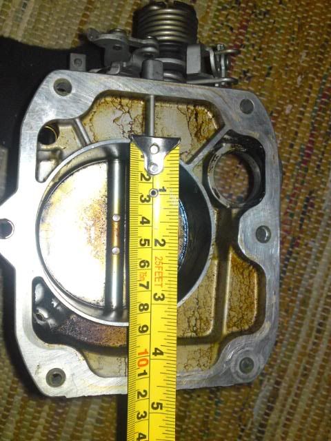

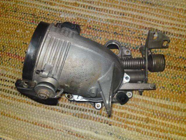

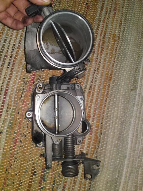

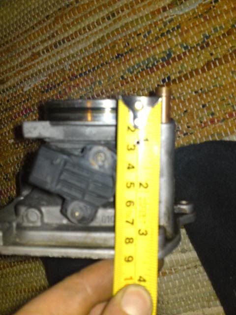

Mark, that inlet looks great in the other pics you sent, keep emailing you back but 3 days later i get a Email not sent warning! god knows why. Any more news on it by the way?

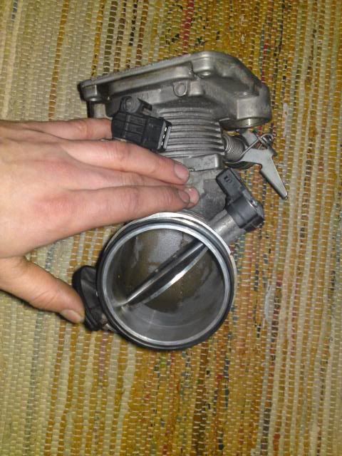

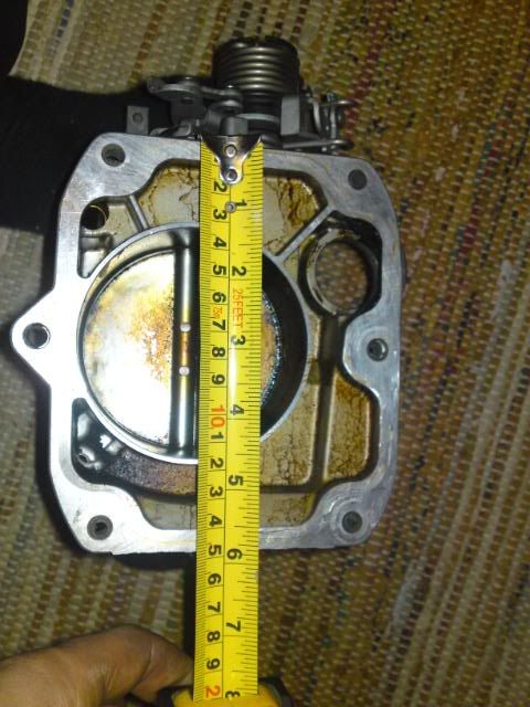

Would a 540 throttle be any good to you? its around 82mm, fits over a 3" pipe anyway with alittle to spare.

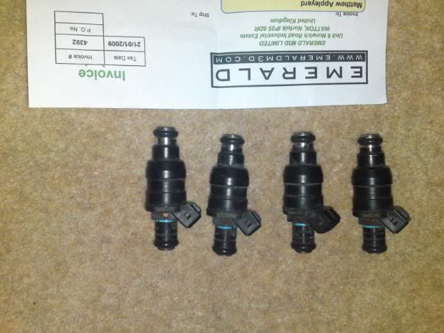

Just done a little more, got my injectors back from being cleaned at Emerald and fitted them to the inlet manifold.
They were £30 and are from a rover 620i but they are also fitted to other rover trubos like the 220.
Cleaning From emerald with new lilters, tips and o-rings was £15 each
For any one intrested there 440cc at 3bar or 460 at 4bar fuel pressure.
Part numbers on the injectors are
MJY100460
D3184GB
0646
Few bay shots for you Rich.
Little more progress, got the bracket for the resivour mounted on the plate i made, used some rubber mounts to holed the plate to the airbox mounts so that i can pick up on the other stud to make a flexible mount for the inlet pipe so it can rock with the engine.

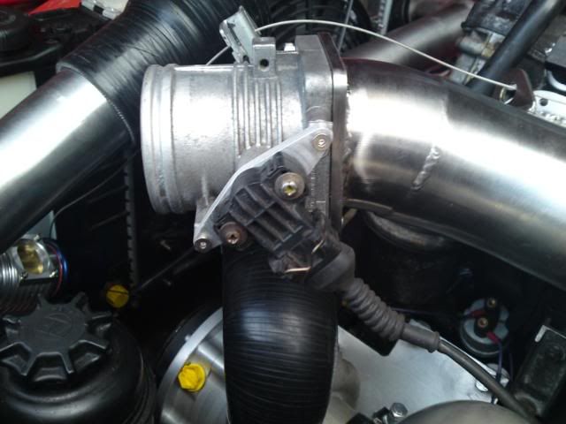

Also got these hose tails fitted today, the inlet is now fitted all sealed up and ready to go! :D

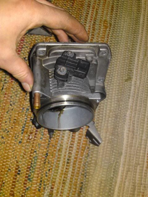

TB pics for you, it mahooosive! think the palte bit could be machined down easy to make it more managable. its actualy two Tb's one normaly open and one normaly closed, is one the traction control? you dont need both for it to work, its a 540 one ya E39
what size trumpets do you need?
Appletree IS supercharged
  • Posts: 66
My Rotrex build going for 300bhp+
« Reply #35 on: February 22, 2009, 10:33:47 AM »
Ignor the throttle pics they were for a freind whos doing turbo 325inlet.

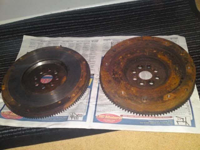

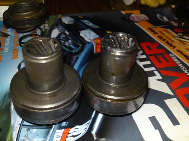

Well another good bit done to the project, been realy busy at work but mangaed to get a few bits done.
After all my questions on the m20 clutch swop ive managed to get someware at last.
thanks chris w, town325i and odbod especialy.

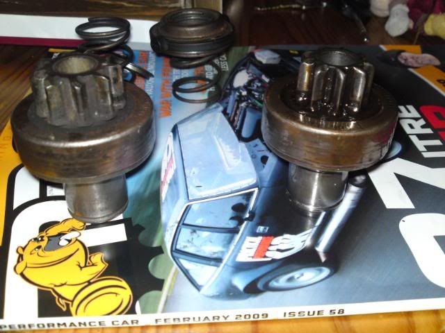

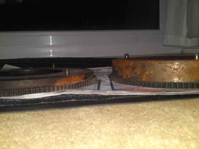

Heres a few pic of the m20 b23 flywheel compared to the m40 one which most uk IS's seam to come with. bit of a weight differance.
Only 1mm differane from the crank face to the back of the flywheel, nothing to worry about.
Had to use a m30 starter in the end an mahine the back of the pinion gear down where the spring sit.
you can see where i had to turn the shamfer back on to the back of the pinion, also had to put the groove back in were the spring clip clamps to holed the spring on the shaft. :D
Now i can run an m20 b25 clutch which should take the torque.
i just have to use the e21 323 release bearing whih was £70! £20 cheaper than the sach clutch kit that came with a 325 release bearing which unfortuanly is the wrong size which is why i need the e21 one
The thing is that the m20 has all the weight near the centre of the wheel which helps more than the weight loss its self. :D

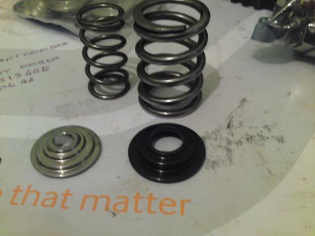

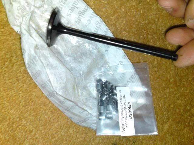

Bought these off ebay last week, Supertech valves with a nitrid coating. there designed for boosted aplications and are solid rather than the sodium filled so there shouldnt be any trouble with them when they start to work hard and get hot in my set up :D
coatinghttp://www.nolimitmotorsport.com/supertech/valvetrain.html
Also bought the retainers, seats and dual springs that the guy was selling. pics to follow
Only problem i can see is that the supertech valves are 1mm thinner on the stem than the standard ones so i will have to get some guides/seals to suit. any ideas?

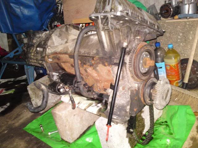

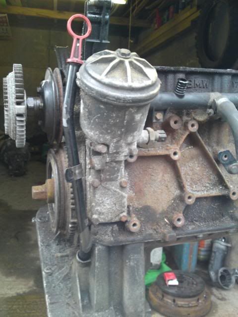

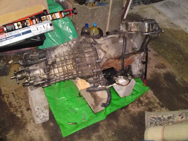

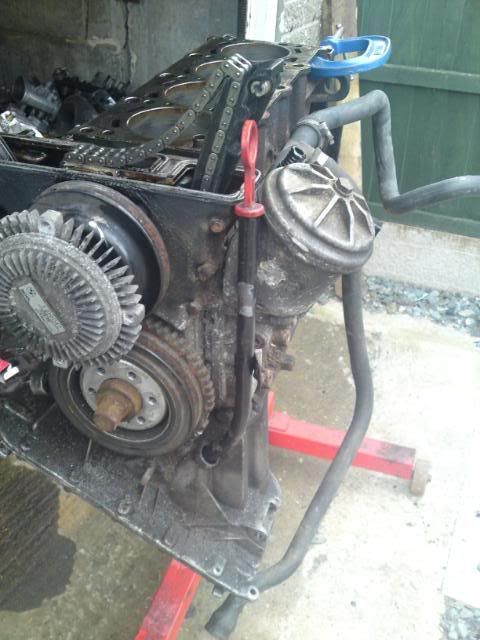

Got some progress on the flywheel swop, got another engine and gear box bolted up upside down and bolted all the flywheel assembly on to it with the modified starter, connected a set of jump leads up and and it burst in to "life"/ turned over :D
No i know it all works i can get it properly bolted up.
i had to turn it upside down as there was no way of sitting it on the floor with the sump still on.
The head was already off when i got the engine off kedge and someones glued the sump plug up so its still pritty full of oil to.
Bit rough but it proved a point :D
Got it running to day, the first vid, running with the trottle set up wrong.
[youtube]http://www.youtube.com/v/DziUacOQJPM[/youtube]
This is later tonight once it had been idling for a bit and the enigne was up to temp, still got a  3000rpm limit for the first 60miles to run the charger in.
First i forgot to reset the throttle limits so the ecu thought the throttle was open but it was shut so it was over fueling, anyway heres the vid of it running properly. need to tidy the bay up now i know it all works ok.
[youtube]http://www.youtube.com/v/GCW9VSA4EpA[/youtube]

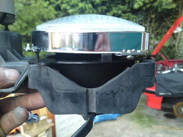

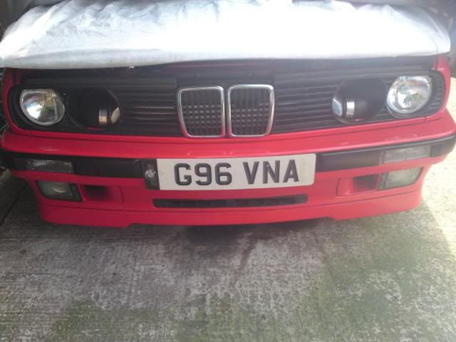

E30 single head lights (all in one)
« Reply #39 on: April 12, 2009, 02:46:21 AM »

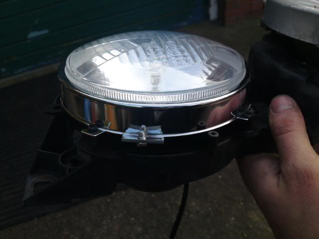

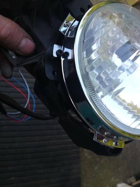

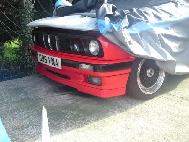

Breakthrough with the lights!!!
It would appear that the kind people at BMW made the bracket for the smiley light just then right size for the new head lights ive got to fit streight in to!!
I'll let the pics do the talking but this seams like its now going to be a case of a few self tapper in to the bmw frame from the frame of my new lights and a loom plug :D
Only thing i need to check is how far back they sit behind the grill but i'am sure its going to be pritty close!
Time for a small up date.
Got the lights finaly working after a small problem, copied the diagram with the relay from rix313s thread to turn the dip feed off when the main beam came on so as  not to burn the bulb out.
Worked fine with the lights on but it ment that because the mains were relying one feed from the dips to supply the mains when the main feed switched the relay if you didnt have the lights on you would couldnt flash any one, say at junctions or what ever.
so spoke to rich to see if he's managed to work out away round it which he had, running the mains off the switch of the relay (main feed> relay coil> lights> earth)
It worked but on my lights anyway it made them dim, probly the coil acting like resistor. So anyway i linked the main feed to the coil to the + for the light and meaning you could flash some one but if you had the dips on you wouldnt be able to turn them off.
nearly there, the main was feeding back through the relay and keeping the main on so.... i disconnected the pin from number 87 on the relay so when the relay switched from the main feed it turned the dips off but didnt  turn anything else on as the mains feed was  linked to the main beem light directly, hope that makes sence :D  :D
So heres the finished look.

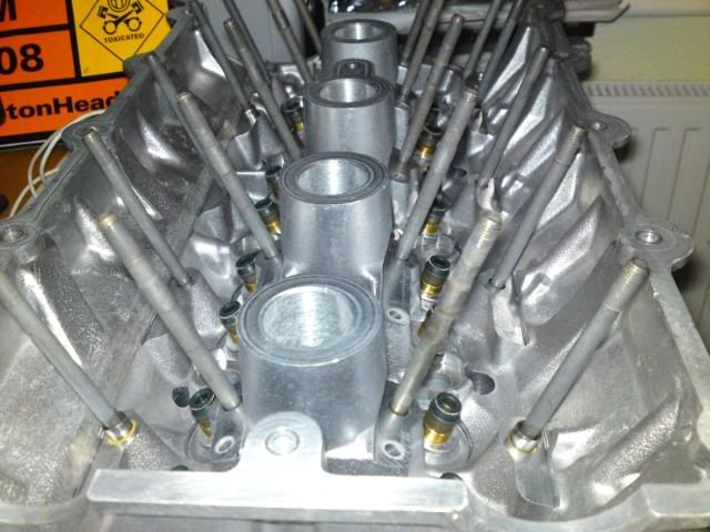

As some of you may know i bought some M42 supertech valves, retainers and springs off E-bay from a guy in ireland from an unfinished project.
These are solid and made of better suited material than the bmw ones for my boosted application.
However, when i got them and measured them the stems were only 6mm not the usual 7mm on and e30 m42,  e30 is the important bit here, emailed supertech ot ask how i was supposed to fit then and made out i'd just got them from one of there dealers.
Turns out then never new the m42 was in a E30 and these valves were made for the e36 m42 which had 6mm valves from  mid 92 onwards up till the m44 came along. however they did offer to make me a set of new guides so they would fit my e30 7mm head for £8 each plus Vat + shipping
Pure luck would have it i bought a  e36 m42 head off kedge last year with a job lot of m42 bits he was selling and the guides look to me good in this so ive have sent this off to be re cut to suit the new valves.
the other problem is that the stem seals are also 6mm and these are also harder to get hold of although ive now been able to get hold of some, and the guides are NLA just so you know.

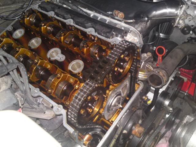

Before the head went off i stripped it and steam cleaned it, heres the pics.

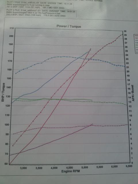

Well, went down to see Dave Walker yesterday and got the car remapped with the new charger on.
Set off from mine at 12 and got to his for 3ish, i can say that a 3hour 100mile drive in a a car that you cant realy use part throttle on stuck behind lorries on the A17 isn't much fun!
I had to keep dropping back, using half throttle then knock it out of gear and coast for a bit to keep the AFRs from going lean.
The journey back was alot smoother apart from a large foam fire extinguisher i had on the back seat went off whilest exiting a roundabout, the hose  was pointing forward and sent foam on to the back of the seats, dash, windscreen and me, then filled up the back seat foot well so i had to stop and clear some of it out, you can just see what i scraped off my arm on to the floor in this pic, luckily it seamed to disolve ok with out damaging anything. :D  Sh1t me up abit :lol:
Anyway, heres the results so far, Asked dave to map it up till it made 8psi boost as i didnt what to go much more than what it was running before still on the standard internals.
BHP - Red
Tourque - Blue
AFR - Green
Boost - Purple
And heres the new plot against the first set up.
Supercharger setup #1 - 205bhp@6521rpm  178ftlb@4310rpm
Supercharger setup #2 - 187bhp@5301rpm  185ftlb@5301rpm
As you can see from the graph the new setup is going to be a much more topend power build and feels as if just starting to get in to its stride past 4.5krpm which is what i missed so much with the Eaton blower making the car much more low down torquey car.
Just looking at the curves and putting a rule next to them if it carries on rising like it appears to be at 6500rpm i think i should be seeing something like 13-14psi boost and 260ish BHP, which int bad but i was hopeing for a little more, so might have to fit a smaller pully at some point although i cant find much info on how the rotrex boost changes as they become more effiecent higher in the RPM.
