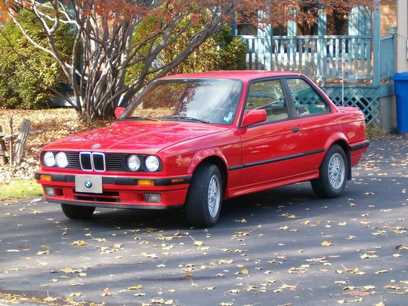

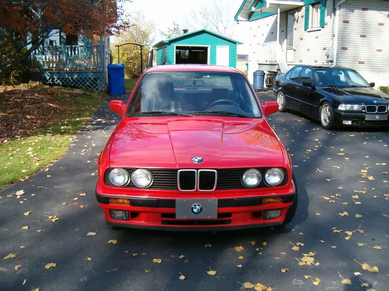

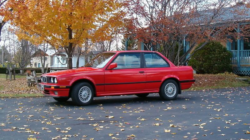

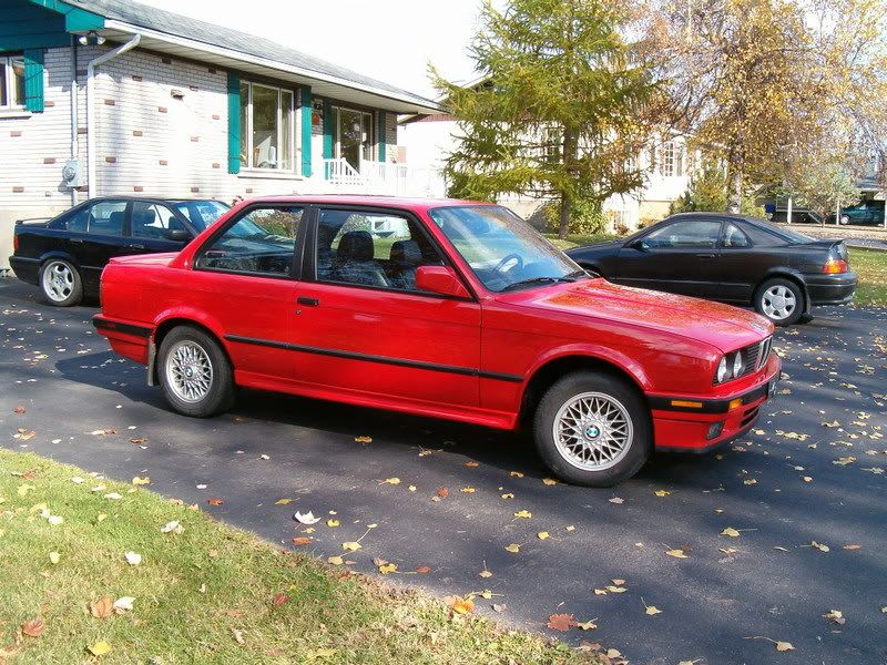

Final after paint
« Reply #43 on: October 26, 2008, 04:14:12 PM »
She's back after paint and rust proofing. :D
Paint was only applied to the fenders and sideskirts then blended to mid door. The hood was only buffed. I installed the sideskirts and the other parts I had removed for the bodyshop.
Many thanks to Phil and Dave for an excellent job on the paint and clean up:D:D:D:D.
Here's the final outcome..........:cool:
« Last Edit: October 26, 2008, 05:25:30 PM by dark_islight »

« Reply #44 on: October 26, 2008, 10:47:36 PM »
wow, what side skirts are those? OEM?
