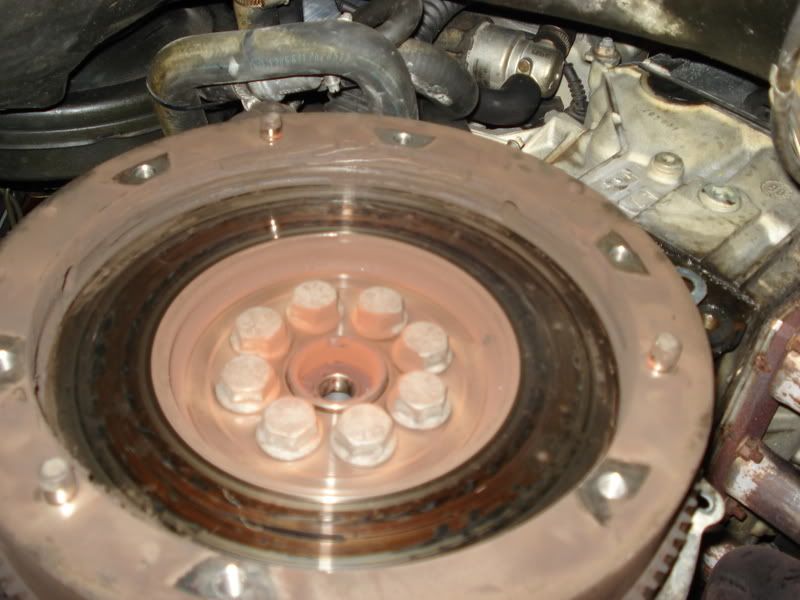

yall just jelous of my "euro" canadian non ac single mass :)... it came as a shock to me when i dropped the trans and has a look at a funny little flywheel

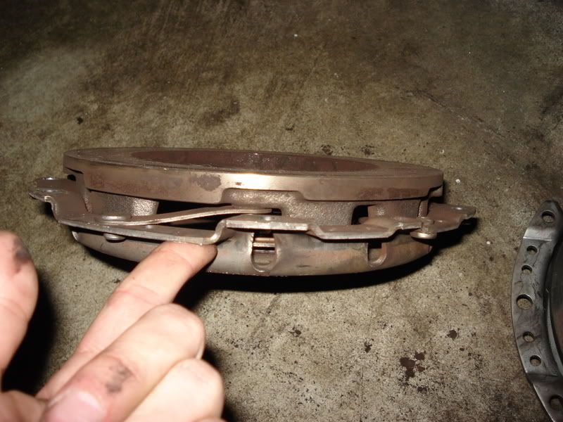

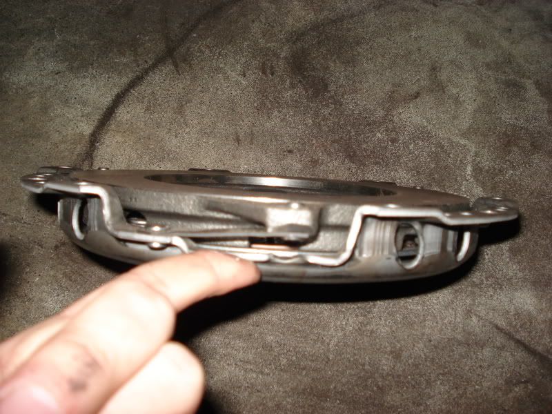

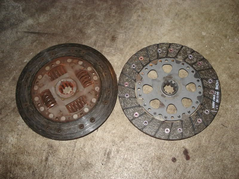

« Reply #19 on: July 15, 2008, 04:12:10 PM »
very different clutch
twin mass
single mass
disks
kenika65
  • Posts: 119
M42 single mass VS M20 single mass conversion
« Reply #20 on: July 15, 2008, 08:52:43 PM »
Lmfao that clutch was toast, hope you at least sanded the flywheel down, if not you might as well pull it apart to remove the glaze, and that pilot bearing is clearly dry.
sha1234
  • Posts: 109
« Reply #21 on: July 16, 2008, 08:50:58 AM »
ahhaha... the flywheel was machined... and most parts replaced for new
