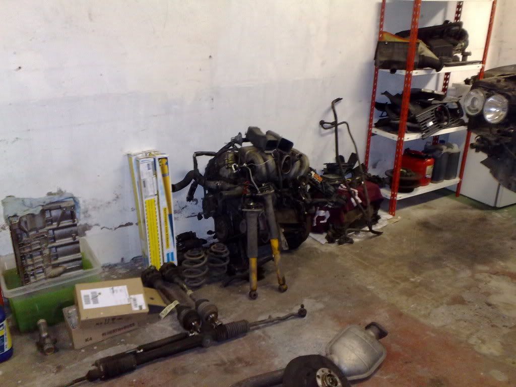

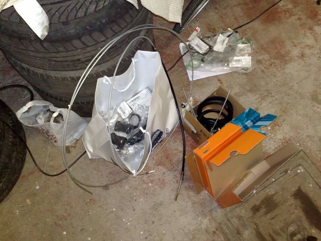

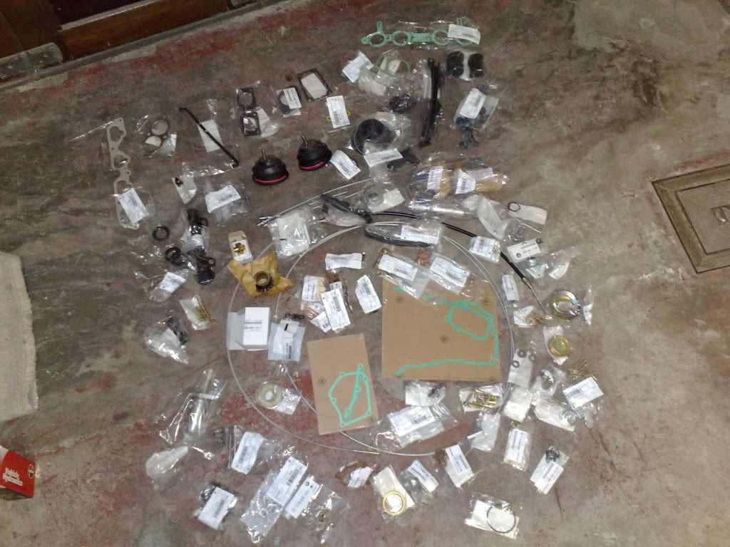

Some things I bought:
Good tools make the work easier
[/URL]
Asserti
  • Posts: 116
Asserti Diamantschwarz 318is
« Reply #18 on: April 26, 2009, 10:36:04 AM »
new springs, H&R - 35mm
And the cleaned parts

arb bushing holders

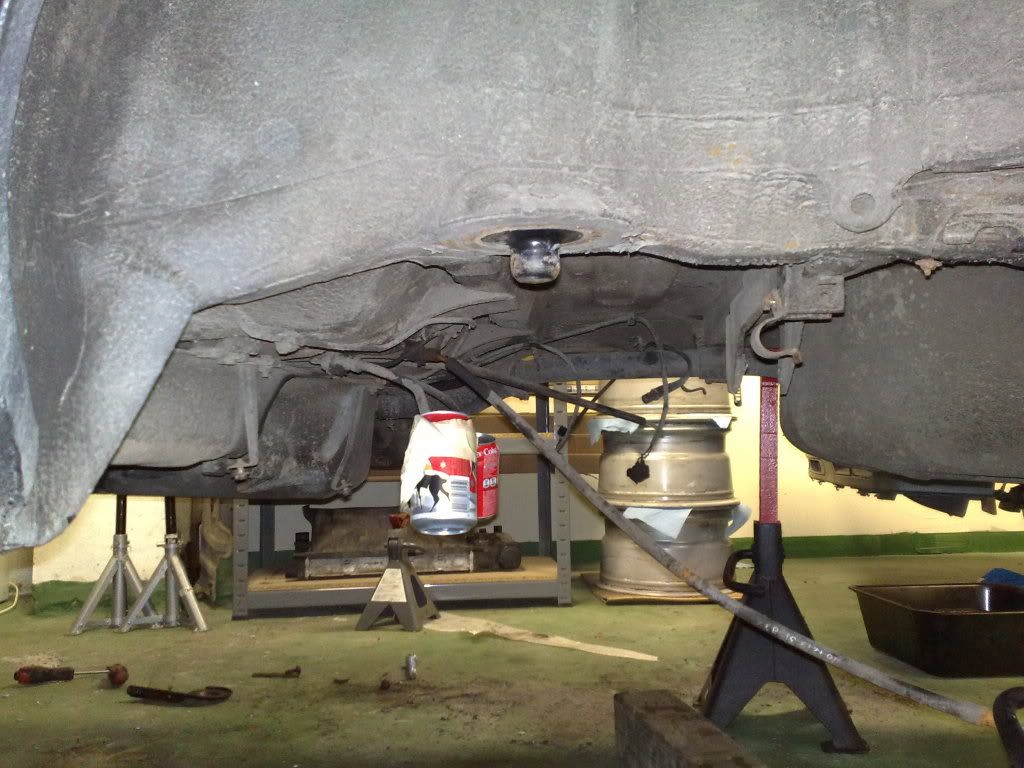

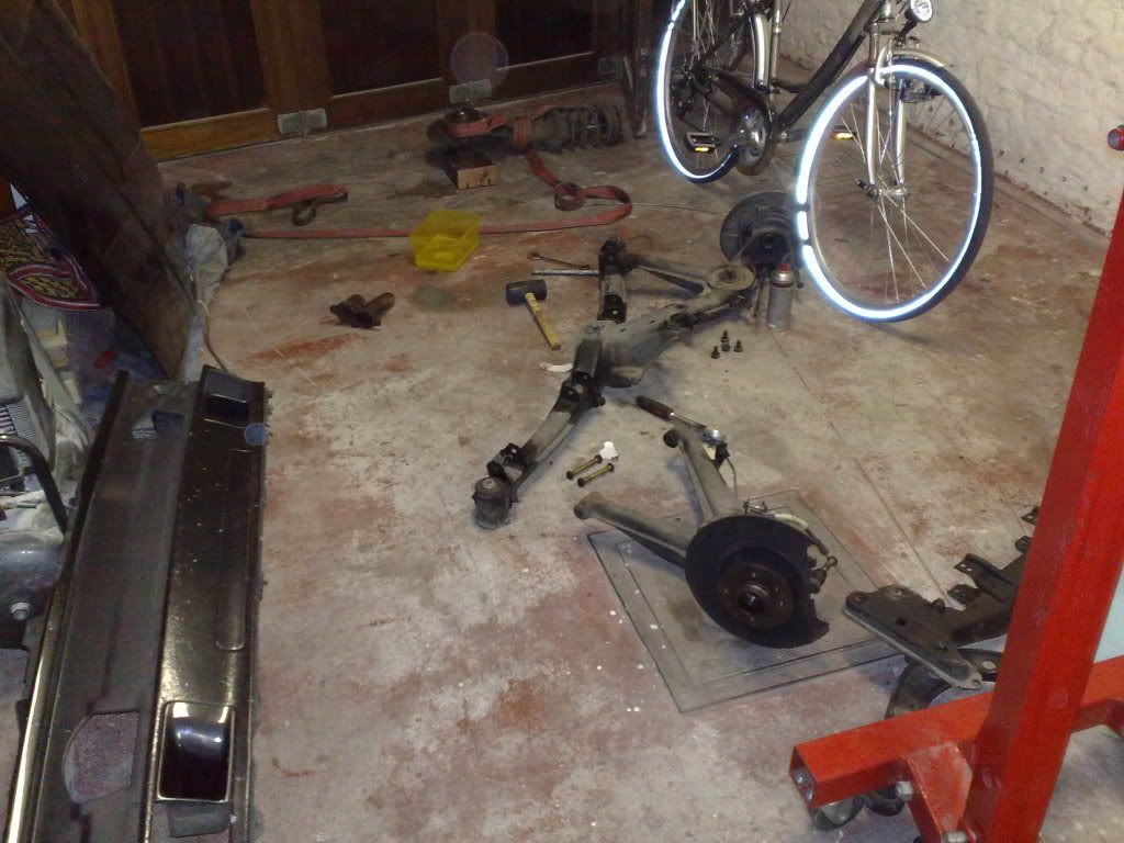

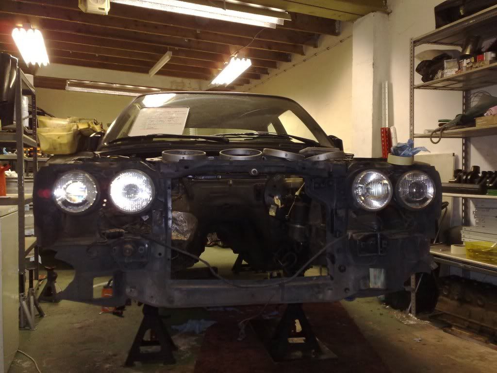

5 Weeks before the deadline, we started working on the car. We decided to remove the rear and front subframe and the engine, leaving almost just the shell and its interior.
Prepartion: street mechanics. Removing the bolts from the rear drive axles
After one weekend, the car looked like this
Two subframes removed.
On a lazy wednesday evening and after 3 hours of work, this happened:
And the car was em-pty
The checklist: (in dutch)

I decided to remove the front also. The car has had a collision on it's right handside, and the front bumper sticks about two inches out of the grill. I wanted to take a look at it and try to fix it (which I couldn't)
Some things removed from the car

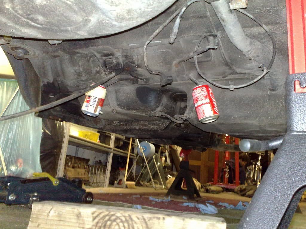

Location of the rear subframe
No oil dripping allowed!

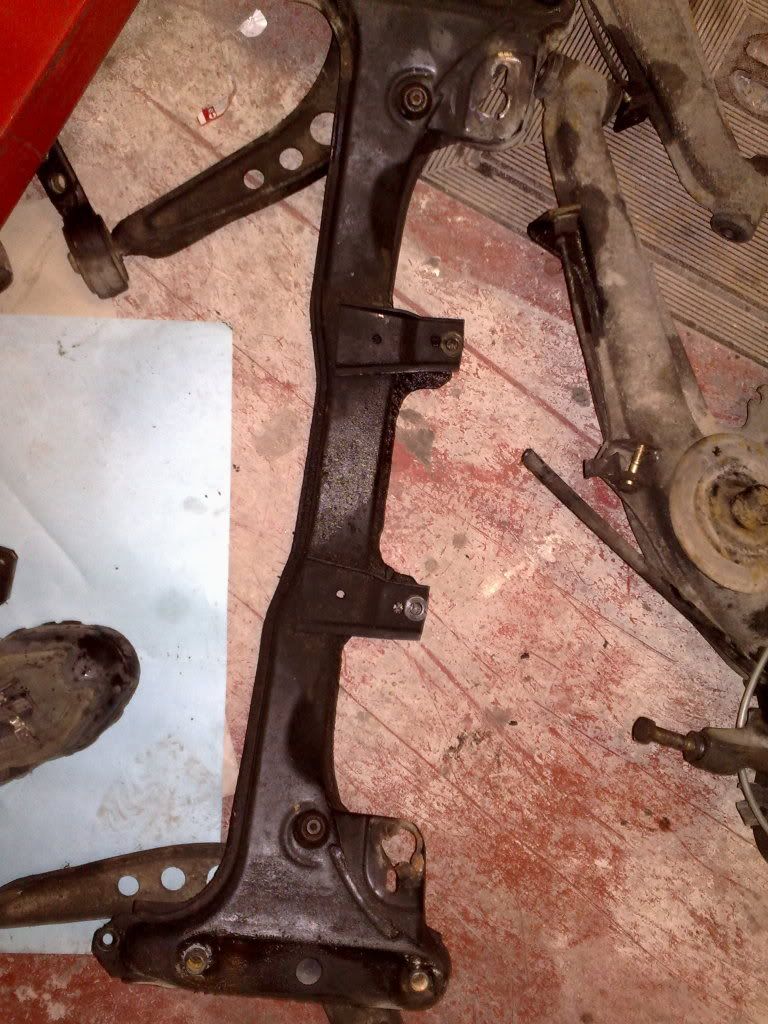

Front subframe?
Removed pieces
Look at the mounting points for the engine mounts :D

After removing the rust, repaint most of the parts
Old new subframe, from a '86 316 :D

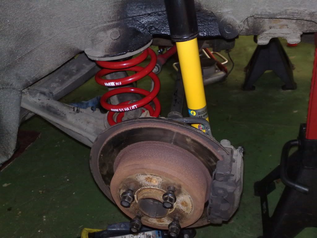

Rear axle with new springs and shocks installed! Looks shiny, doesn't it?

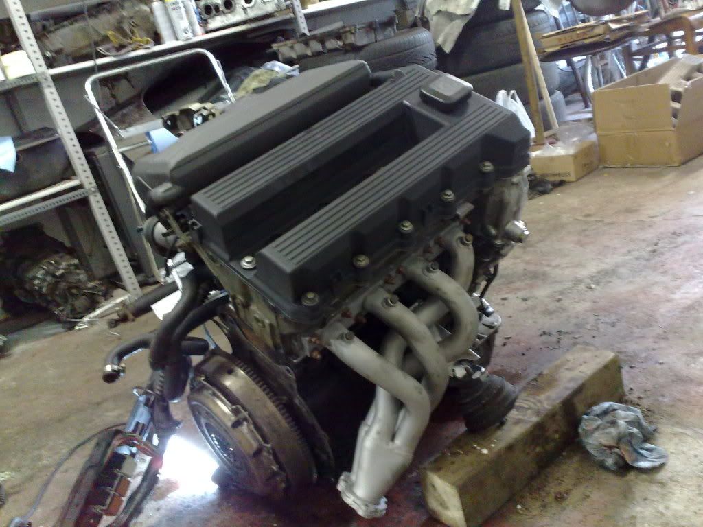

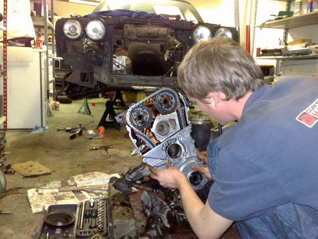

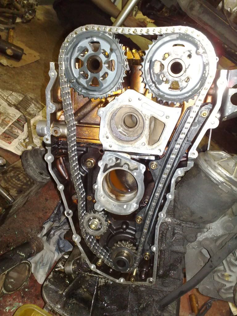

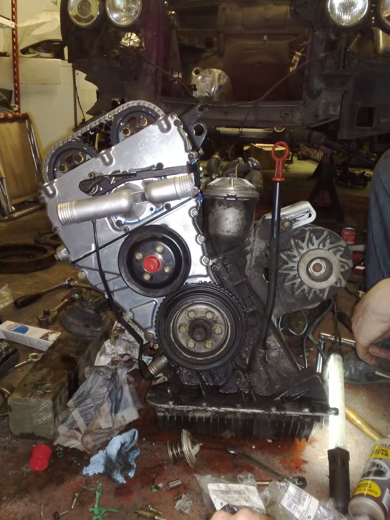

On saturday, I did the timing chain job. It took me far more time than expected, but I did it very slow, making sure not making any mistaks

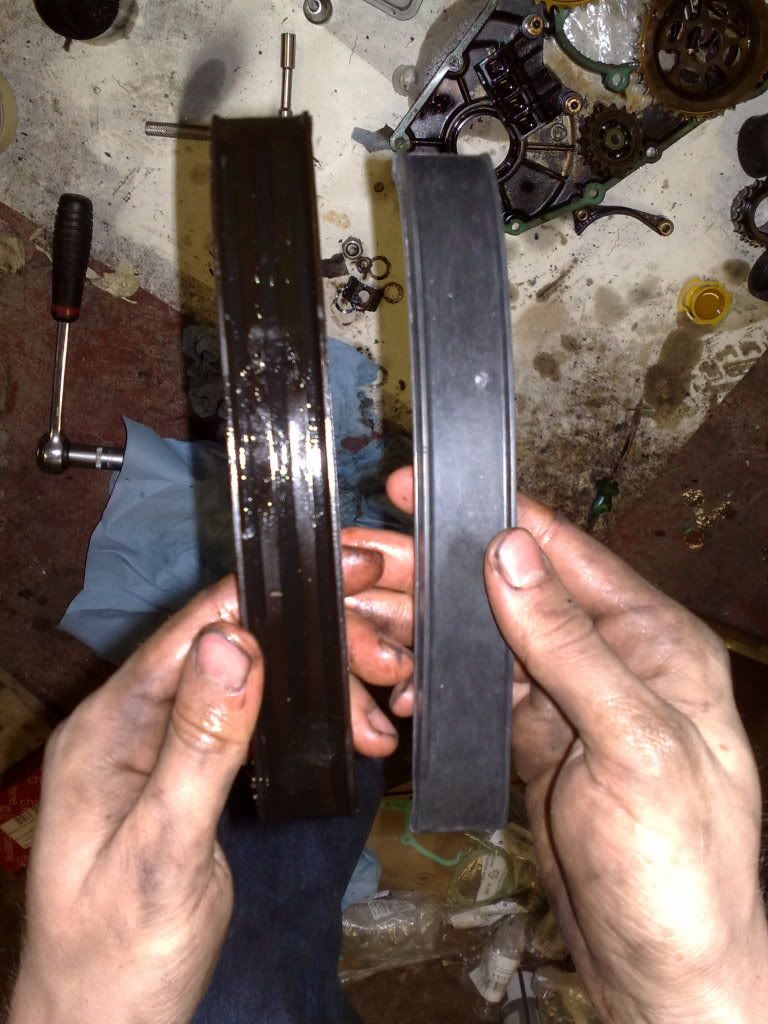

Old vs new chain guide. Doesn't look bad at all imo?!

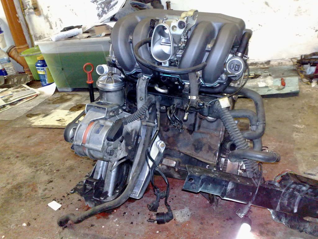

The engine, after the timing chain job

Saturday evening, the engine was almost ready for installment. We still had the sunday to work on the car, Monday evening we had to be at our hotel in France.
Sunday:
I also renewed most of the vacum hoses under the intake. I left most of the water hoses apart, I renewed only the hard plastic one and the two heat change thingies. I have no leaks, luckily.
Engine compartment cleaned and front subframe installed. I also renewed the brake lines to the back of the car, a new clutch slave pump, ...
Moved the engine back in, renewed the oil seals of the gearbox, installed 1.9 Z3 short shifter (I just realize that I have no pics of those things. Sorry, we didn't had that much time left :D)
Putted the body parts back on, installed the exhaust, used new engine mounts, gearbox monts, and a lot of other parts that I'm forgetting at the moment.
After + 14 hours of non stop working, ordered a pizza at 12 o'clock in the evening :D, the car was ready for it's first test drive. 6 o'clock in the morning, easter monday.
Putted the contact in 1, the dash came alive and the water temp popped into the red. Damn. We came fast to the conclusion that I switched the connectors from the oil pump and the water temp sensor in the head.
For the people who knows the M42, they know that the water temp sensor is nicely hidden away under the intake. Not wanting to remove the hole intake mess, and with the help of a screwdriver, I managed in less than 20 minutes to remove the connector, switched it on the oil pump and pushed it back on the water temp sensor. Try it yourself without removing the intake :D
Second time, everything seemed ok, started, wait a few second until there's some fuel in the lines, engine puffed, one more, vroam. M42 was back alive. No rattles, already popped out tensioner did it's work good!
