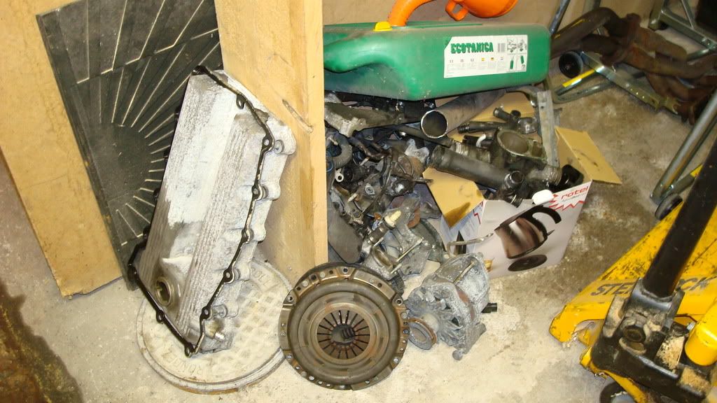

yep..i found it!!! but a lot of money... for a piece of metal with two holes...!!
a swiss 318is racecar
« Reply #61 on: March 03, 2008, 03:06:40 PM »
Quote from: romkasponka;44047
Our sum is olmost dry, you should cut front part and with welding close the hole.. In thread about itb there was link to US company which have dry sump set for M42.
can you make a drawing of your idea???

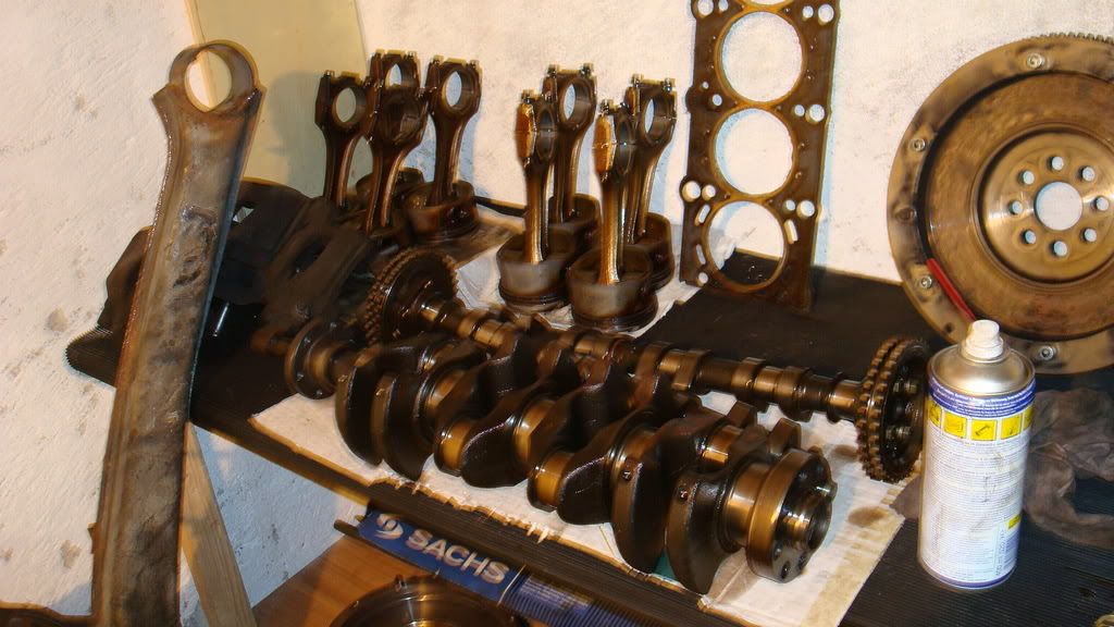

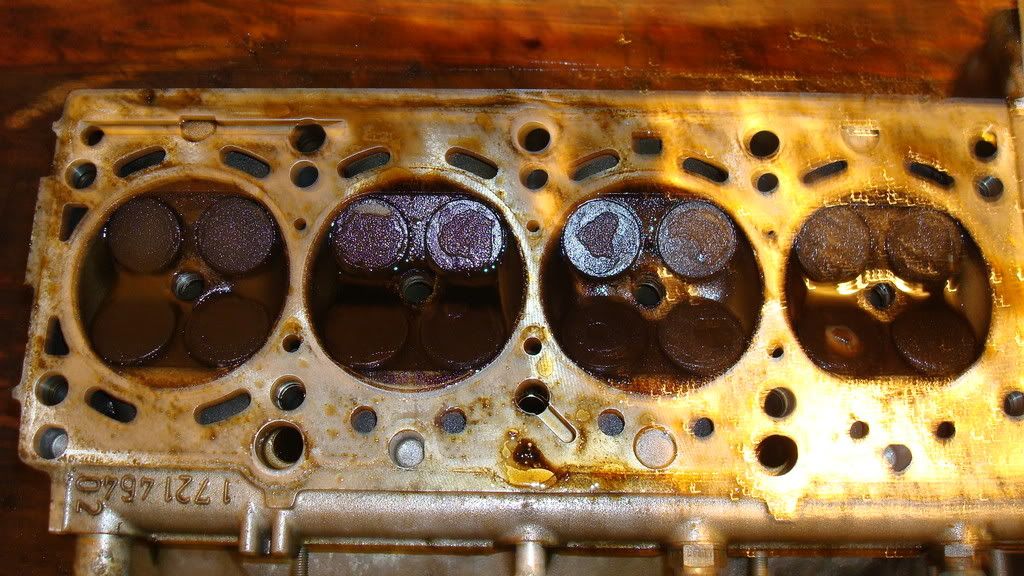

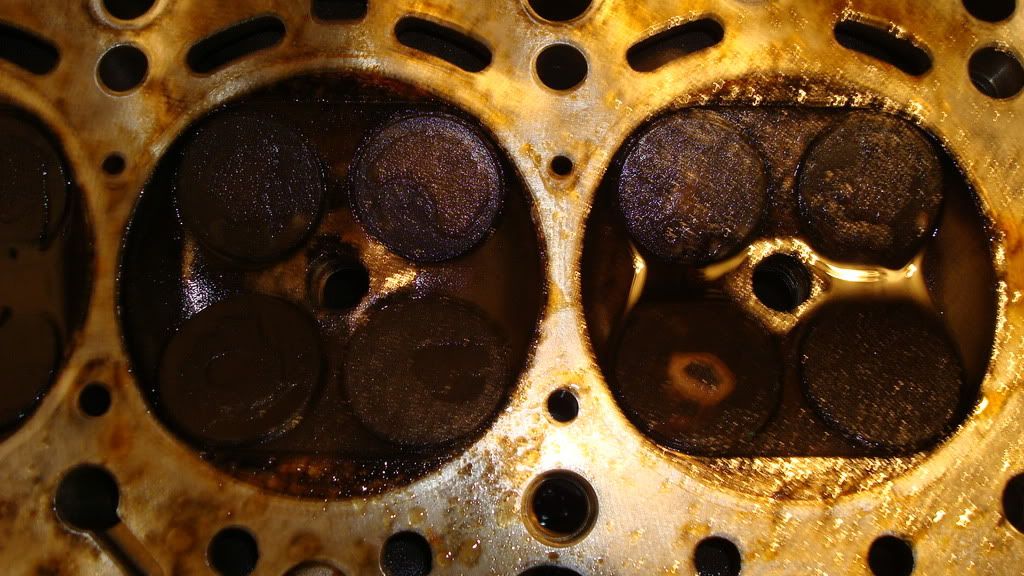

i dissassembled the spareengine for my S42-2Liter-Turbo engine project...
it was an old engine...
how do you clean combustion cambers like that??

Quote from: swiss318is;44891
Disassemble head, tape off water holes, and bead blast. I do this everyday at work (part time engine builder).

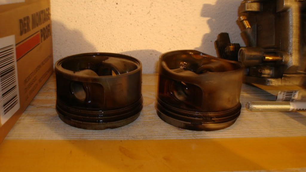

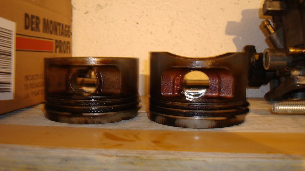

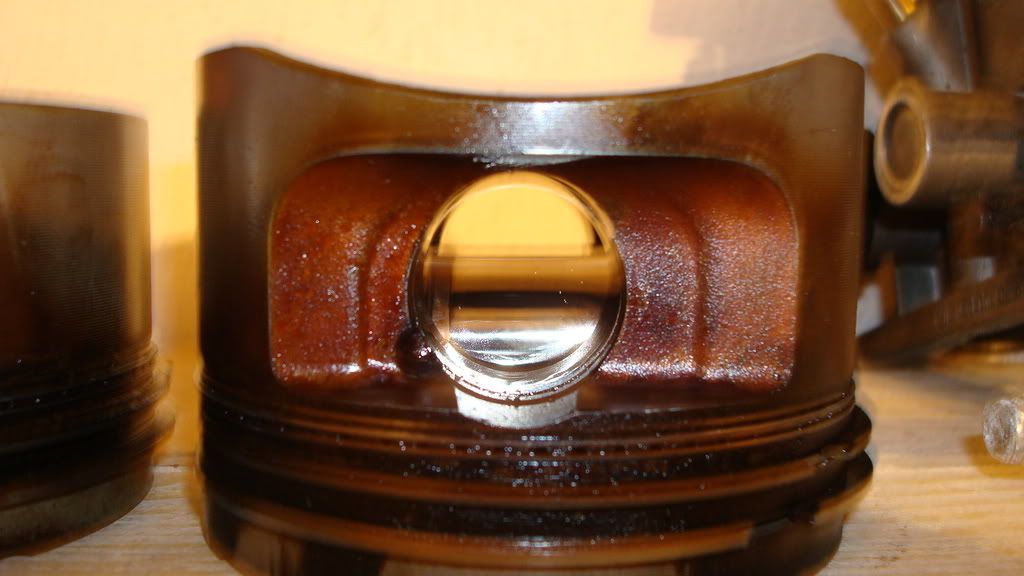

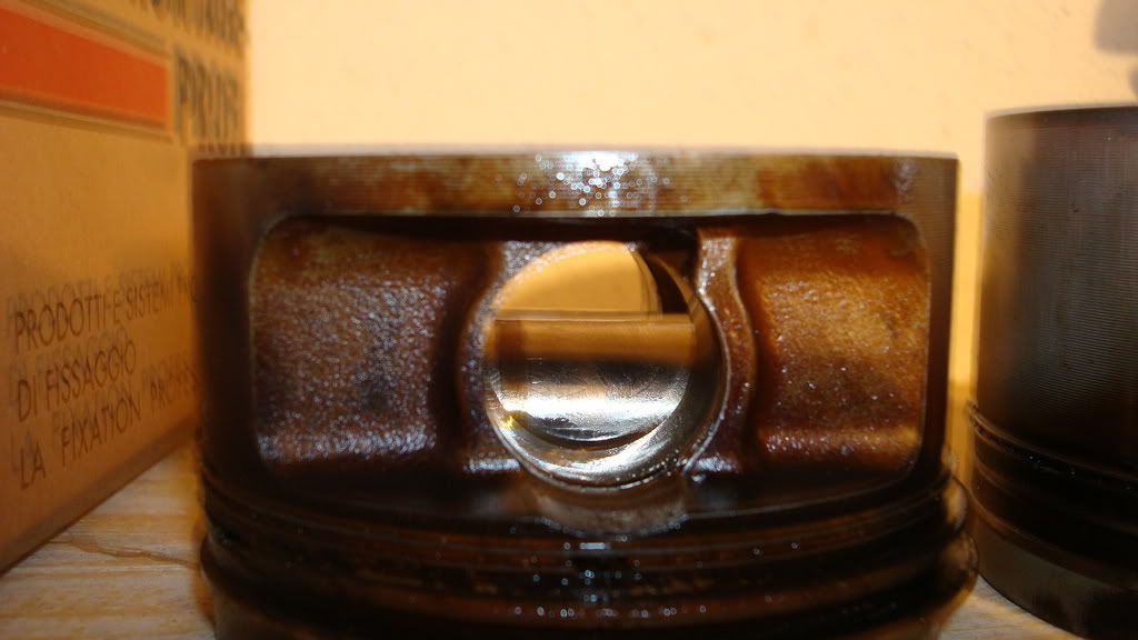

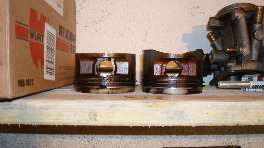

i found some interesting things... 2 different types of pistons.. does anybody have some infos about the different pistons in the m42b18 engines?? i have got 4 and 4...

« Reply #73 on: March 23, 2008, 01:12:46 AM »
the E30 and e36 m42 pistons are differents! same bore, same compression height, but different combustion chamber volume...
all sizes are in mm.
KH=compression height
VT=valve recess depth
MT=combustion chamber depth
Mdiam=combustion chamber diameter
GL= total lenght
here are 318is E30 piston specs:
here are 318is E36 last M42 piston specs:
« Reply #74 on: March 23, 2008, 05:05:03 AM »
ok. but the above pistons are both from 318is e30 cars!! not e36! one is 89' and the other 90'...
but thanks anyway for the "mahle" pics and infos
