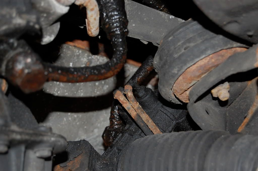

i am in the process of doing a powersteering delete.
if anyone has ever done that, i'd be interested to know how to link both sides of the rack together so the fluid can move freely. i will plug the fluid holes on the columns with M14 screws but i have no clue on how to link both sides
the only idea that comes to my mind is that i could cut the metal line and fix flexible fuel lines to them but thats a bit sketchy, i'd rather do a clean job.
anyone know the thread of the metal rails? so i could buy an hollow screw to fix the hoses to it??

i understand the issue of the pressure buildup but i'd like to clear the engine bay, and i believe the system is a considerable weight that will have to go
what are the bmw racks that don't use PS ? maybe i can inspire myself of their design or simply replace it

thanks. i will fill with new Redline fluid and flush a few times when the weather is nicer and the idea of running it open from lock to lock would insure no pressure buildup although would there be enough fluid for lubrication?

thanks thats exactly what i wanted to know, i will opt for the drain and plugs. would you know the size of the plugs i need?
