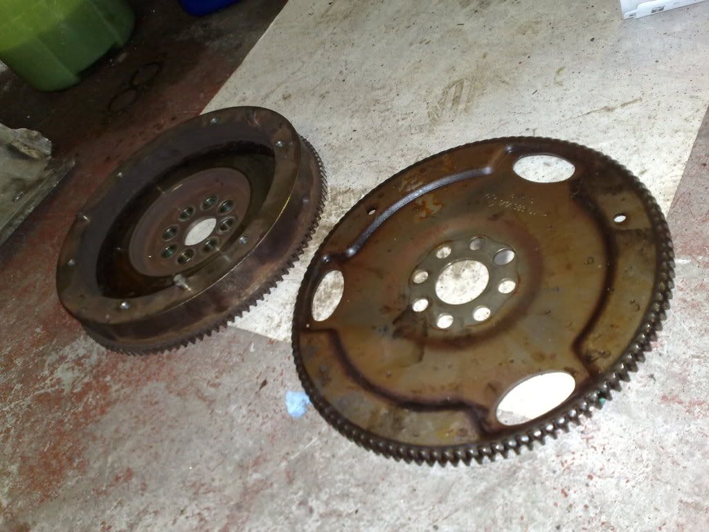

« Reply #96 on: April 12, 2009, 04:43:11 AM »
Can anyone confirm if this flywheel (the left one) is a single mass one?
thanks in advance!
