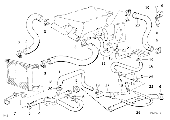

Personally I wanted to be safe so i bought hose number 16 and 18 in the below picture cut a piece off the pipe(26) to join the two and used some hose clamps.  There is no stretching at all on the hoses they all line up and fit perfect like it's ment to be.

I want to get rid of the mess under the intake as well.   I am not sure whether to go the cap route, or go with a hose that connects the heater manifold to the nipple in the engine.   One snag on this is the manifold is, as I understand it, about 5/8 of an inch, while the nipple on the head is about 1/2 inch.   Has anyone tried using a peice of expansion hose, where it has the larger end and then goes down to smaller hose?   Its about 10 bucks or so for the extra hose, but you can probably use the other part too on your fabrication of a new system.   I just may do that,  when I buy all the other hoses and gaskets and stuff to do this job so it lasts a while.

Geoff - I purchased a silicone hose kit and used a piece that was good enough to stretch over the water outlet pipe end (hose 18) and to the nipple (hose 16).  I clamped both ends and called it good. Hasn't had one leak yet!
