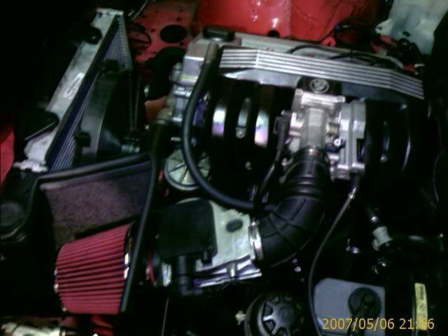

first off, sorry bout the pics.. only gotta camera phone

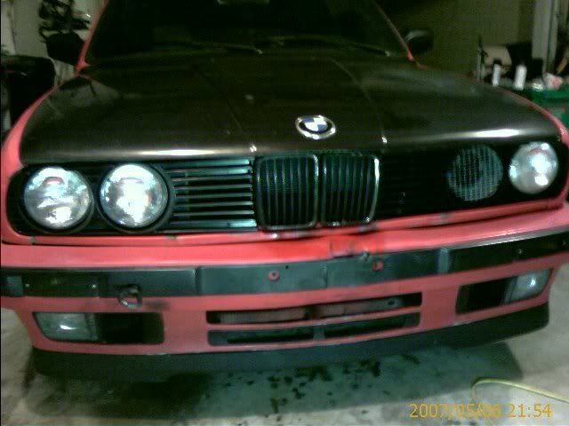

heres what my car looked like before
and heres how it looks now...

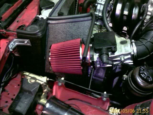

and the reason for doing so...
specs:
cheapo ebay air filter - Bomz Racing (nice because it has the inner cone for increased surface area)
Lukas motorsports heatshield
mounting bracket from true k&n intake kit for the m42
1991 318is : brilliantrot

where did u get the heatshield from? I was thinking of fabricating my own from home depot ;)

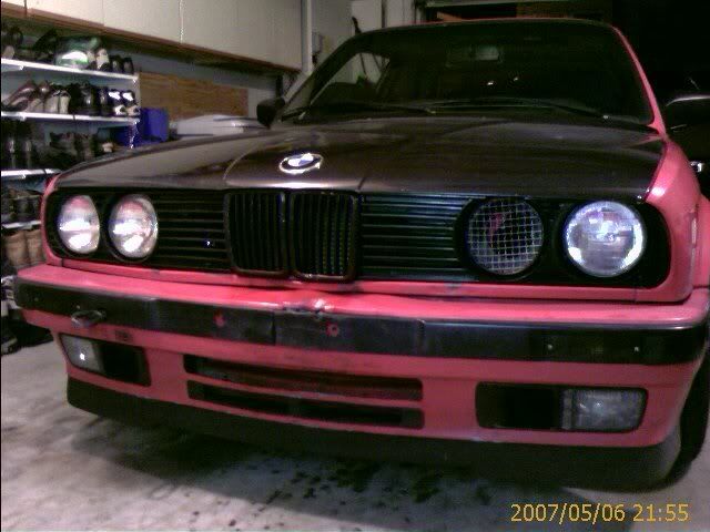

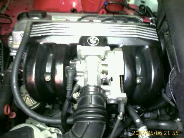

Getting there man.  I like the manifold.
Hey I designed a mesh opening for the headlight opening.  It was a finer mesh.  Want a pic so you can see?  I used the head lamp ring.

sure id love to see it.. i juss used what i had.  where can i get that finer mesh?  also, i recently got the car polished waxed and cleaned.  ill get some better pics up soon.  the hood and front end damage well be fixed/replaced soon enough.

I like what you did with the manifold. I think I'll try that while I have mine out. Thanks for the idea.

heatshield from lukasmotorsports.com
when youre painting the intake manifold, make sure you get all the cosmoline stuff off (that flaky yellowish gunk).  if you dont it will cause your paint to flake off easily.

I washed, sanded, degrease, sanded again and washed again before applying the first coat. I used high temp paint rated to 1400 degrees. I like this shade of black.

Applied 3 more coats 30 minutes apart then carefully sanded the highlights. masked off the sanded area and painted again to cover up any scuff marks in the paint. The finished product.

The headlight opening is probably the best place to take in air on an E30. You could move your outside air temp sensor from the brake duct to check the actual temp. It's an easy HP and MPG gain.
I've painted the valve cover but have been just too lazy to pull the intake. I guess I could do several other things on the list like the Gordian knot of vacuum, coolant, etc. lines under there also. COSMOLINE, Aghhh!

No problem.   I will take some pics for you tomorrow.  I got the mesh from a really great store here.  Surplus stuff from every business know to mankind. , Skycraft.

d.clay when you paint your intake manifold you should also do the coolant bypass.. thats basically why i painted mines
