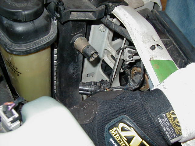

« Reply #23 on: April 28, 2007, 11:11:25 AM »
just install the OEM fan sensor in the right side of your radiator and use the OEM fan of the >95 E36's

« Reply #27 on: May 03, 2007, 12:17:21 PM »
this is an m3 radiator but its the same sensor in the same place for all e30's and e36's radiator
