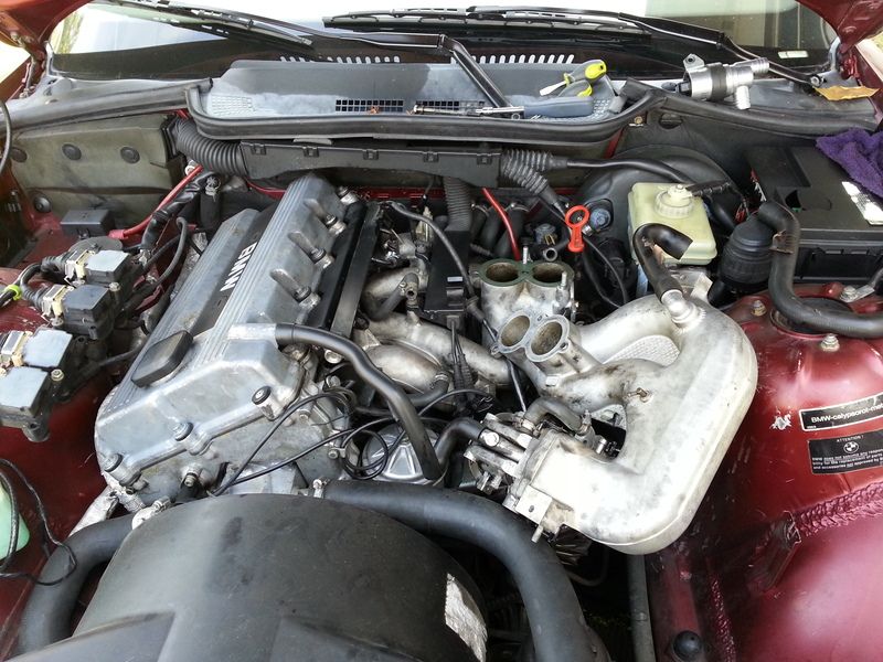

I just finished cleaning the maf, cleaning the icv, looking for vac leaks, getting air bubbles out of cooling system, cleaning tb replacing the spark plugs....

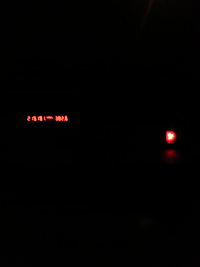

A trick that might help tell you more about whats wrong is called the "stomp test" which Uses the computers internal diagnostic program to help locate problems. While some people hate this program because it can be extremely vague on some of the codes it gives off I have always found it pretty useful because it at least narrows down the problem to a particular system that you can analyze more thoroughly.  I have included a link which will show you the procedure for doing this test (its very simple). Hopefully this can give you a little bit of insight but be warned it can be completely useless at times (*like crank sensors faults even though it does have a diagnostic for this and code*) :P
https://www.pelicanparts.com/bmw/techarticles/JF-Tech/E30_E36_On_Board_Diagnostics%20.htm

I'm reading 1214
Can't find it in the list of codes!!(my luck).
1213 is lambda
1215 is air sensor
« Last Edit: March 22, 2015, 01:04:38 AM by 559e36 »

replaced the crank sensor with an oem one but it didnt fix it!
it ran a bit choppy for a minute and the idle bounced from 400-600 then stayed at 900 and after a few light revs it's chillin at 600 constant.
it looks like the cam, crank and tps were all changed recently so now im left here scratching my head like wtf?
new plugs
cleaned icv
cleaned throttle body
cleaned/inspected tps, cam sensor, afm
replaced crank sensor
checked for air leaks and sprayed carb cleaner around all hoses lines while running(nothing happened)
checked all my coils
feels like im running on 3cyl and it idles at 600.

Stomp tested again after clearing codes this afternoon and im still getting 1214!!
