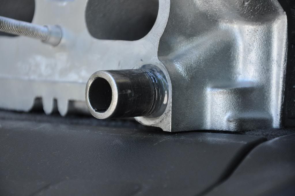

in the past few weeks the little m42 had a incontinence moment when the heater matrix pipe snapped then shortly after 6miles the heater matrix feed pipe of the head split open, it had just rotted away, but i spose on a 300k mile engine i will allow little moments like this, one day later it was fixed, i had my machinest make me a new stainless part i then threaded the head so it should never ever leak again, will have to do the same on the one forward of this as its not to happy either

NICE! I had mine threaded too, but it's not barbed at the end like yours.
Good shit man. Glad you were able to get a fix, seems to be a common problem, for the life of me i couldnt find a fix, so i came up with my own solution.
Wish you posted this a week earlier  ;) ;D :P

the barp on the end is a major point to miss dude but you may get away with it,
