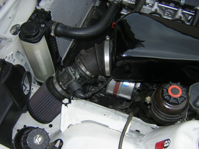

pics of my MAF
« Reply #35 on: December 27, 2006, 05:31:58 AM »
Hi BMWman
hope its not too late, see the pics of my successful DIY conversion below -
U requested for it a week back.  I'm not sure if the OEM connectors for this is easily available but it seems to be the standard 4 pin round BMW plugs that you can find in various other applications on the harness.
What i did was just get female bullet connectors, solder it to the harness, and directly plug it to the MAF to the corresponding pin. I then just slip the original rubber boot over the whole connection.
I just lifted this MAF from my mechanics parts bin. Its Siemens and the opening measure 2 3/4 inches.....anyone can confirm what MAF this belongs to?

Hmmm, the element in that one is even more open!  The design has no backflow protection at all like the Bosch one I am using.  Maybe the E36 M42's dual-intake system was designed to help with exactly this or something.  Lol, hrmmmm.....maybe the E30 M42 is the hardest motor I could have picked for this.  Guess I will have to call up my sister and convince her to let me make her car a guinnea pig!
Thanks for the pictures!

The MAF above looks like an M52 one. hotwire MAFs shouldn't require much air density correction, because they respond to density changes at same air flowrate unlike the AFM. Having said that I use IAT based density correction as it gives me more consistent results, and yes, heat soak is an issue for me with the IAT and the sensor is just on the entry of my (fibreglass) intake plenum, so a long way from any alloy engine-attached bits. as far as IATs go, the later BMW sensors (M44 among other models) are calibrated the same as the IAT within the M42 AFM.
