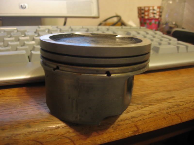

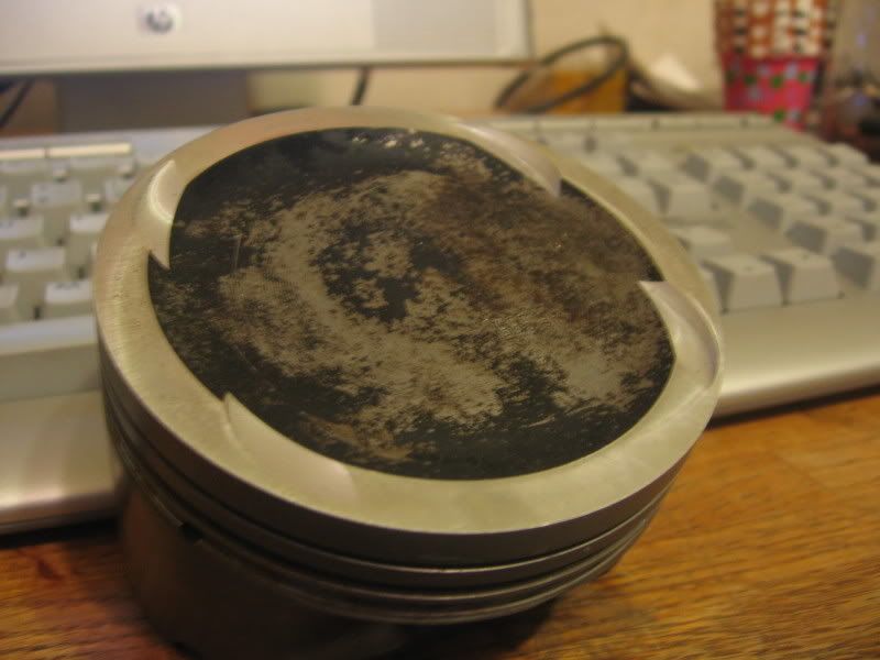

I had the block bored for the S52 pistons   $200
The guy I bought the pistons from had planned on using them in a turbo motor and had had the oil ring groove modified for Total seal  rings so I called up total seal and got a set of rings

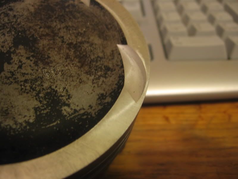

I FINALLY found time to finish the pistons.  I ended up milling 2mm off the deck and then I had to redo the valve pockets.  This turned out to be a huge PITA due to the funky setup I had to do.  I am happy with the outcome though and I dont think there is any way that the integrity of the pistons was compromised.
I also have decided to use an M44 crank even though it is cast and not fully counterweighted.  I have seen M44 make plenty of power with superchargers or turbos and they seem to hold up just fine.
This isnt a race motor by any means and I'll be keeping the RPMs to 7200max so i'm not really worried about the crank.
I am still going to double and triple check all my measurements but heres what I have:
Combustion chamber volume 34CC
Piston dish 10cc
deck height .5mm
Displacement will be just short of 2 liters.
According to a few internet calculators, I should have ~9.5:1 CR.  A little lower than I hoped, but that makes my decision to boost it much easier :D

Pics!
Valve pocket detail.
