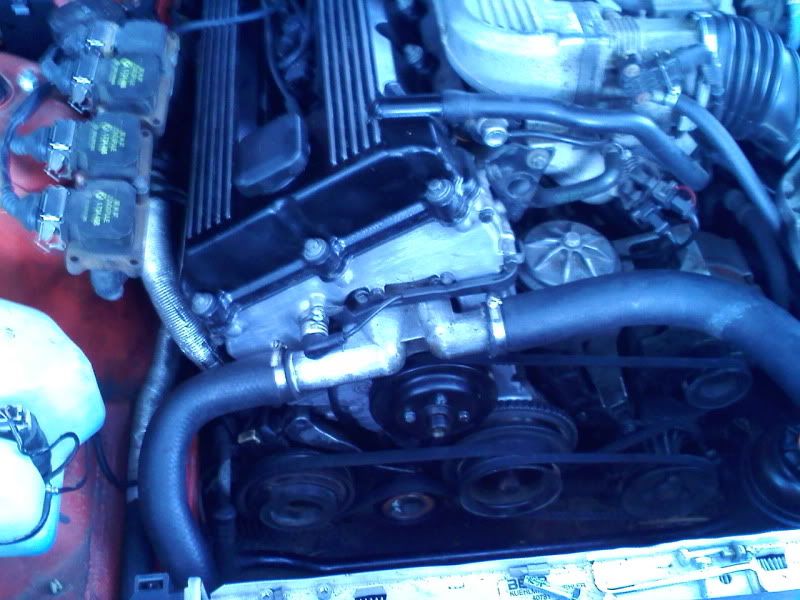

My a/c belt has always run over the tensioner like pictured. The belt is tight and everything. And also i have an e36..that could be why
The PO must have setup up the coil packs wrong cuz they are labeled 4231 from rad to firewall..so thats the way  the spark plug covers should go as well right? not 1234

« Reply #21 on: July 09, 2011, 08:32:38 PM »
Just deleted a pic of the a/c compressor support and belt because I just realized you have an e36 with a serpentine belt.  The belt position makes perfect sense the way you have it.
