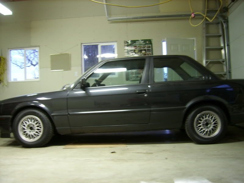

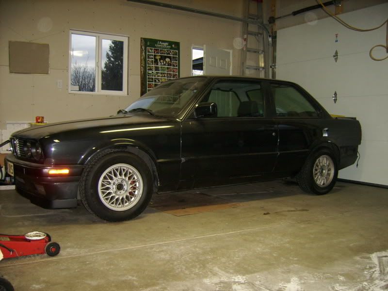

so i gotta say, it's kind of embarassing posting the first images of my car on this website, and it's for the cheapest thing i've done to it!
but oh well, i've got broad shoulders.
also, i want to let you all know that i don't neglect my car this much; it's just in storage and i'm in school full-time. but by the summer i'll have some nice 'washed' pics.
so this is with 2 coils cut off the front:

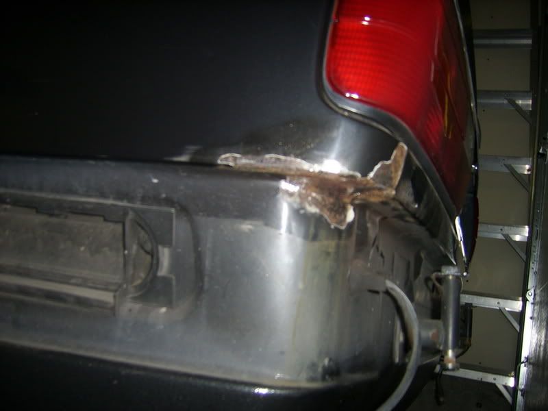

and this is the reason the rear bumper is off:

hope it helps you out
